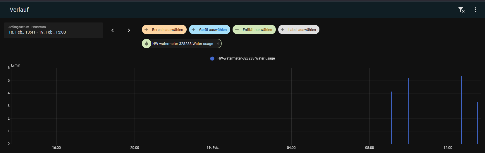

I have a Zenner watermeter and it has one gauge with metal on top of it.
I’ve tested and the Homewizard reads that gauge. I’m now wondering if the homewizard reads it correctly because the gauge is the x0,001 version so 1 cycle of that gauge is 10 litres. Does the homewizard think that the 1 cycle is 1 litre?
