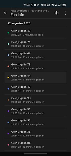

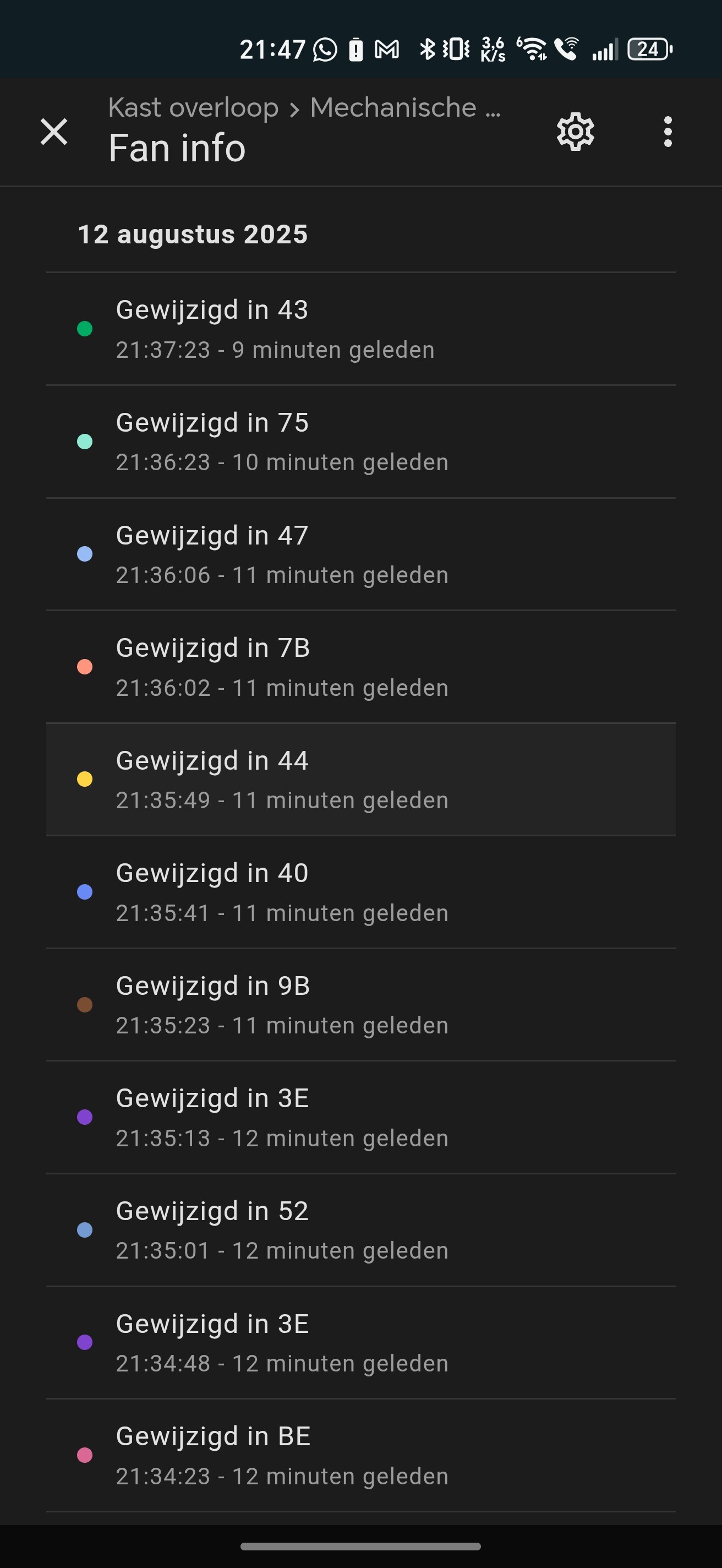

Hi, first, thank you Egbert for picking up the integration, I was afraid that it would die a sad and silent death.
Previously my fan (CVE) would only report speeds in 3 types, speed 1,low, speed 2, auto and speed 3, high. I use those reported modes on a few automations, but since this new version it reports all kinds of values for fan_info
Is there any translation for this “new” 2 digit codes? Because as it stands, my automations fail and panic. I use the fan_info to check if the fan received the command to speed up or slow down.
