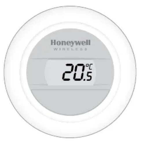

Hi all,
Im trying to get my setup up and running but i’m a bit stuck. Would appreciate any help or direction on how to proceed.
My setup:
1x BRD91 wireless relay (13:043374)
1x Honeywell wireless thermostat (21:006924)
1x INDALO-TECH usb stick (18:134388)
Im able to pick up on RF traffic, added the Honeywell thermostat(THM) and BDR91(BDR) unit as known devices and stopped listening to all other traffic. Both devices have created entities that update as expected (the Honeywell gets a temperature entity and setpoint as an attribute, the BDR an activity and relay demand entity).
What I’m trying to achieve is being able to controle the BDR unit when I want to start heating, but I’m completely lost on how to be able to do that. Faking the thermostat does not allow me it seems to adjust its temperature or setpoint, and I’m not seeing any particular traffic from the physical thermostat that would indicate a command to open/close the relay.
Any thoughts on how I should proceed?
Setup a issue here for the new firmware 02.47.00.01 on the Evotouch:
@Yardco what type of thermostat do you have? Evohome? usually you cannot control directly the BDR. You have to set the temperature higher that what the thermostat reads.

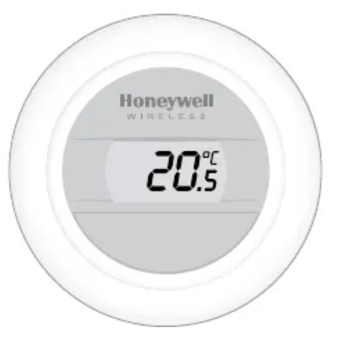

It’s a Honeywell wireless (round) thermostat (T87RF1003).
If I understand correctly, the only way to make the BDR unit open/close is by adjusting the temperature of the (faked) thermostat? I’ve tried to do this by using the services in developer tools, but none of them seem to be able to adjust the temperature/setpoint of the temperature entity. In the log it shows that it should be a 03:xxxxxx device_id, yet mine uses 21:xxxxxx
I’m no expert on this,I have a evohome, but I think you may want to try and fake a controller and a zone for you to get the controls to operate temp changes on that round. But I may be wrong.

Thanks for the suggestion! I’ll look in to faking a controller/zone to see if that will work.
