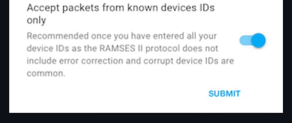

Accept packets from known device IDs is set
To on? Because if you don’t have any system set up yet, you need to set it to off to “scan” (listen) for any devices. Once you know all your devices, you can put those in the known list and than switch the switch to only listen to known devices.
Apologies I misunderstood
