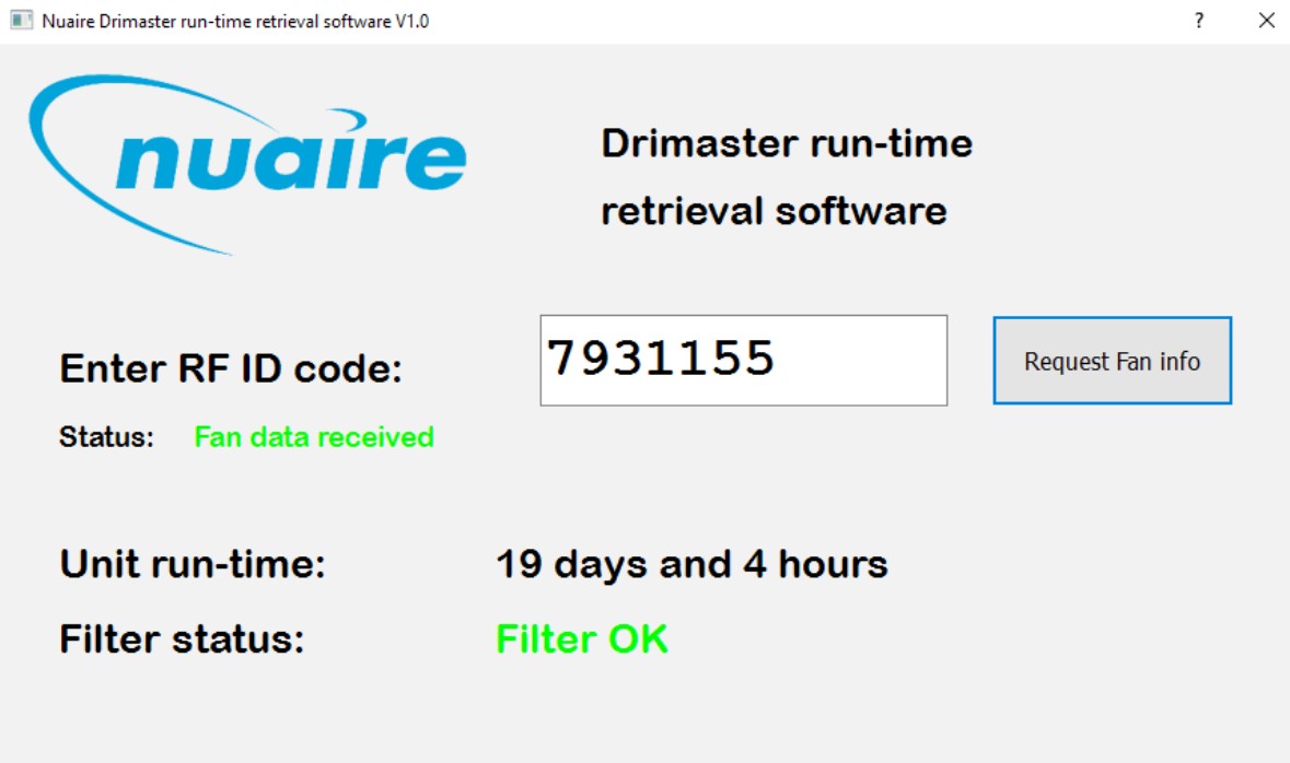

I also have a Nuaire Drimaster PIV (DRI-ECO-HEAT-HC) and I’m interested to see what can be achieved.
I note the Nuaire Drimaster Remote Monitoring Device (DRI-ECO-RM) provides filter status and run-time hours. I don’t have this device myself, the picture is taken from their datasheet.
It’s unclear which HVAC codes they map too, but if that is known then entities could be created.
