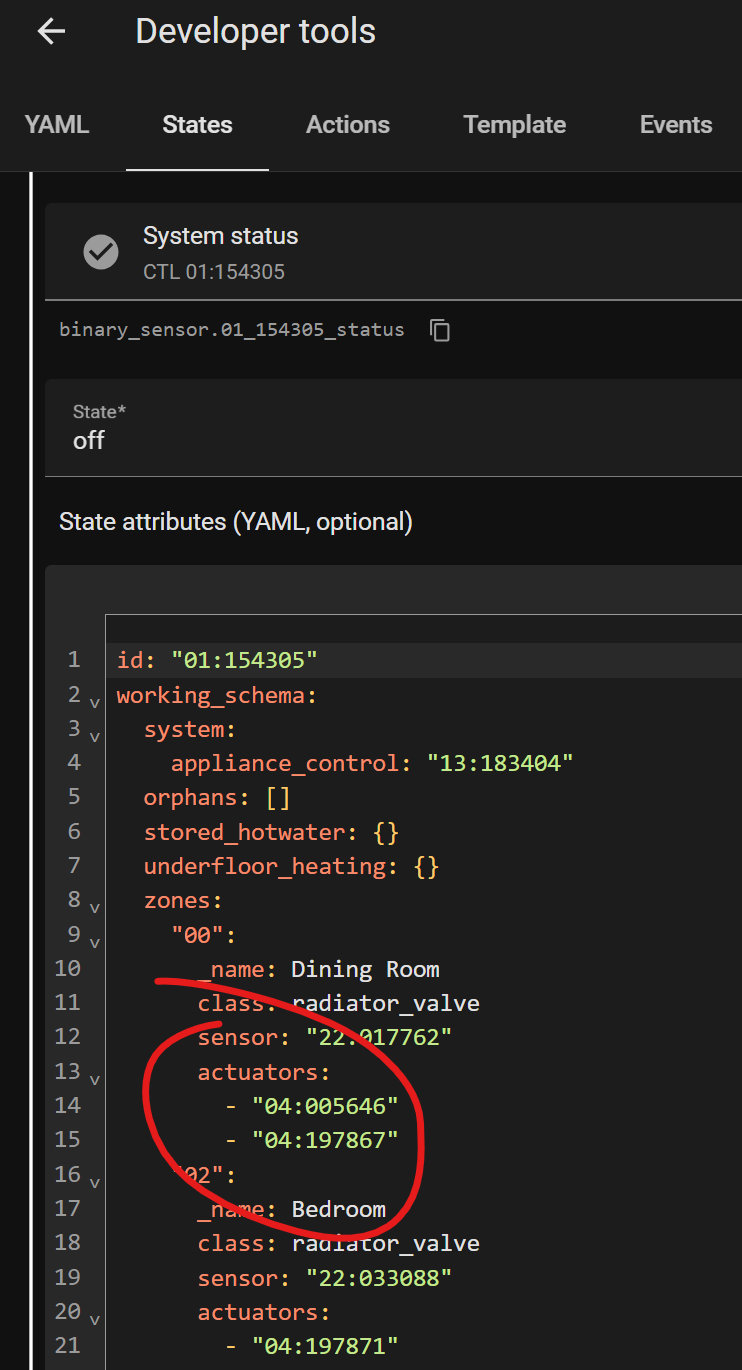

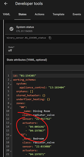

Check your system controller sensor in Developer Tools, you should see the the TRVs associated with the zone as actuators, they start with 04:xxxxxx
It should be automatic without any special configuration, best practice is to add all devices to your known list.

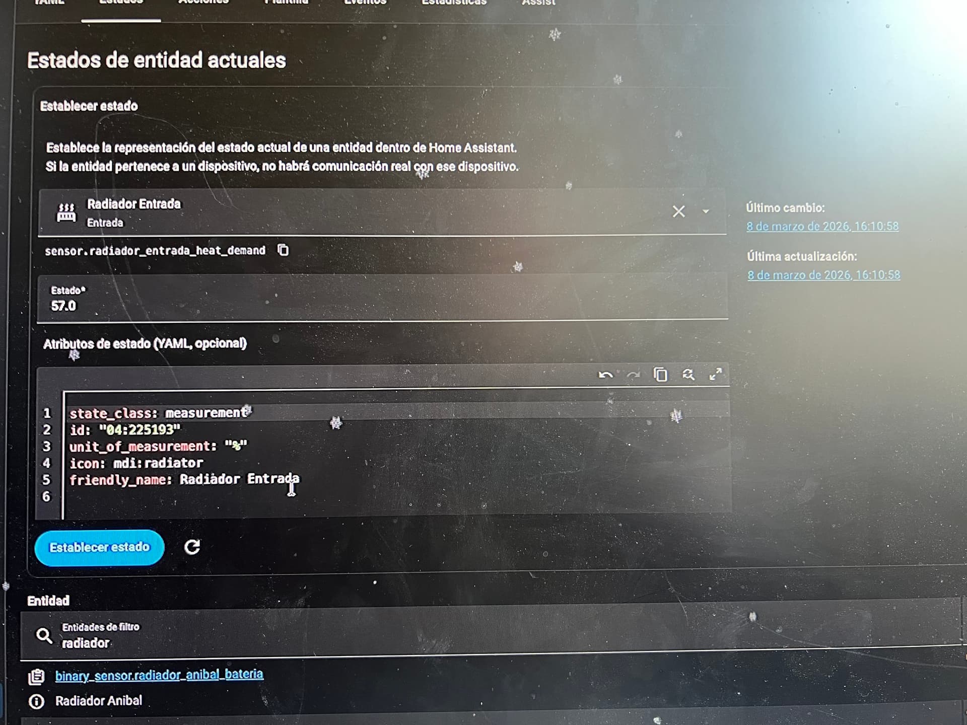

i am in developers tools and for my apprear like this.
my hr92 start in 04:xxxxxx like you but what i need to do next ?
Thank for your help friend :slight_smile:

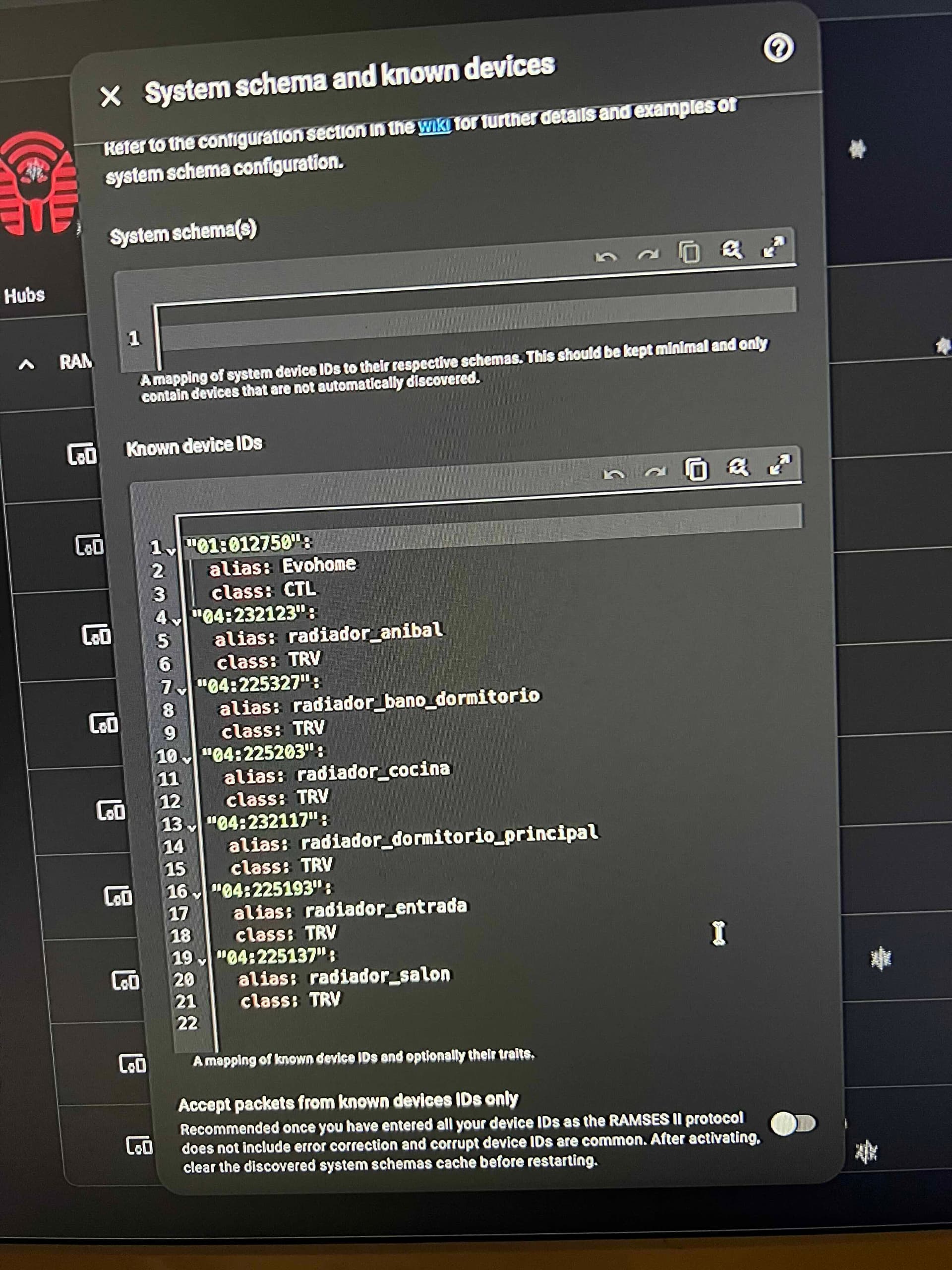

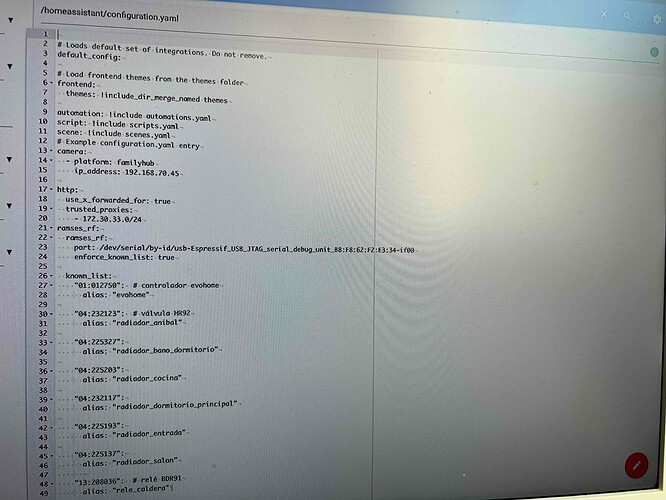

yes i read it and the USB dongle its correct, it appear in home assistant but the entities that it give me, are wrong it give me sensor.room and i need climate.room i read that i need to create a list called known_list and i think it refer in configuration.yaml of home assistant.

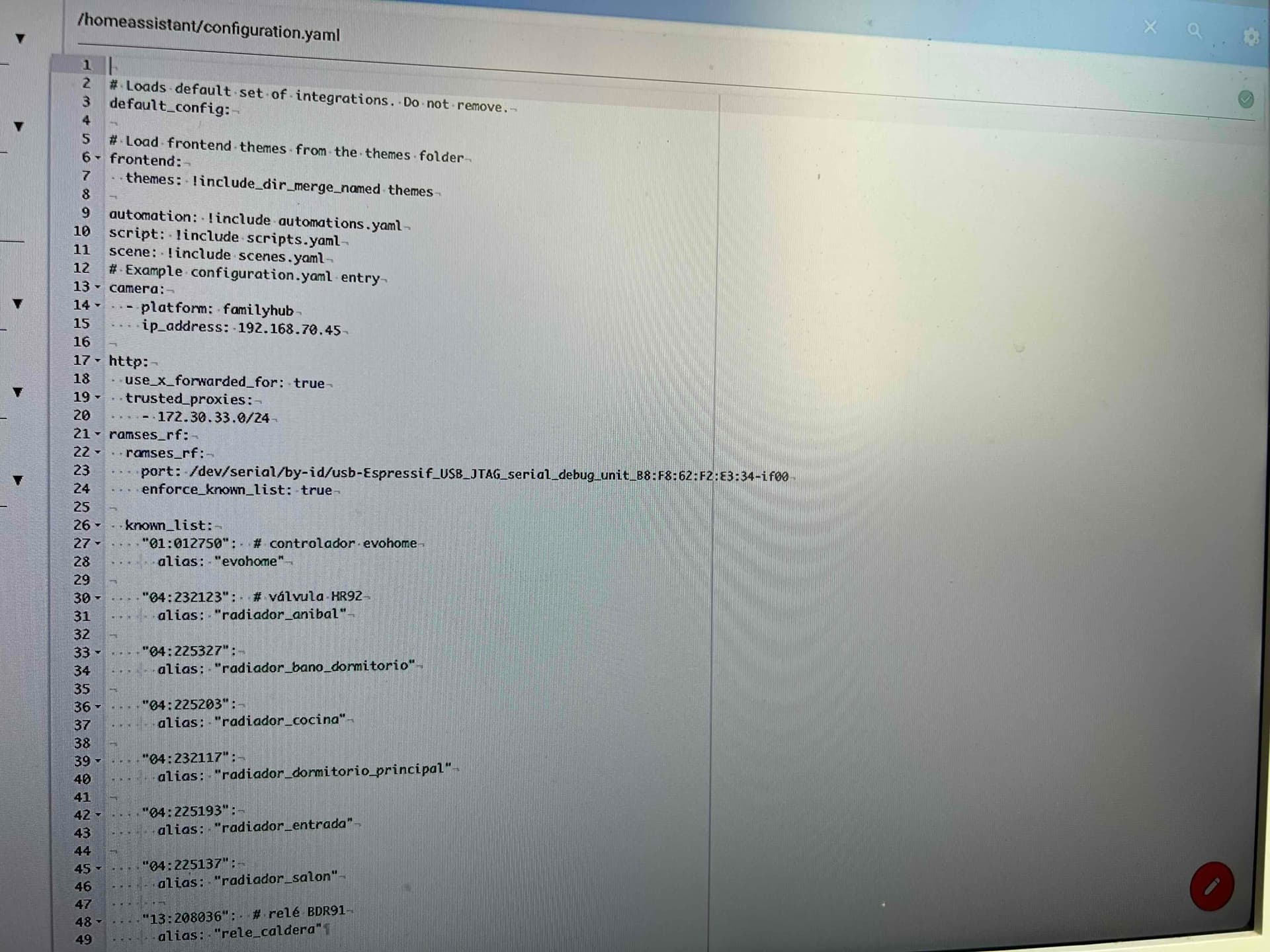

im doing that rigth now but the issues still happend.
the yaml code is correct file editor give a green dot in the corner but when i check in developers tools home assistant tell me that ramses_rf integration not exist and i dont why home assistant give that, maybe reinstall the integration but something tell the error still hapend because i need to make a list of known devices

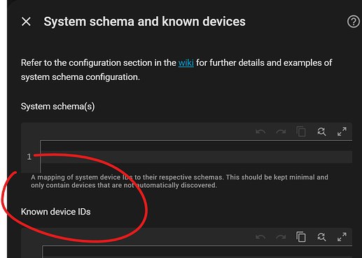

It’s all done through the UI workflow through the integration page
Here is an example system. However, you want to disable “accept packets from known devices IDs only” until you have a fully working system. Once everything is working, set this to true/on.

i do it
what i do now? wait to all system refresh ? where appear de TRVs? in the ramses integration?
Than you for all your help
yes it should refresh once you put in the gateway

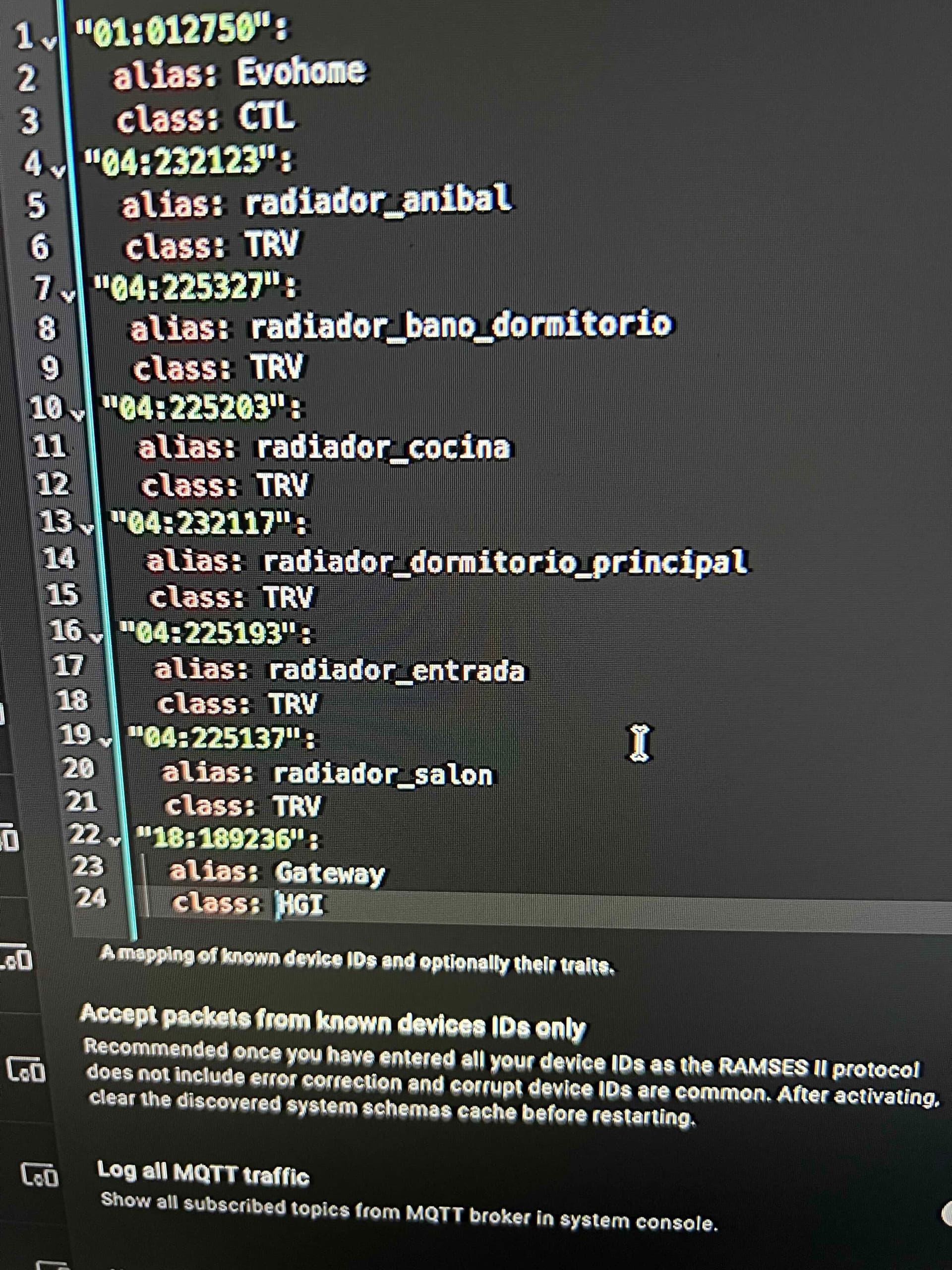

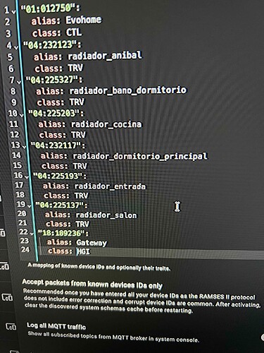

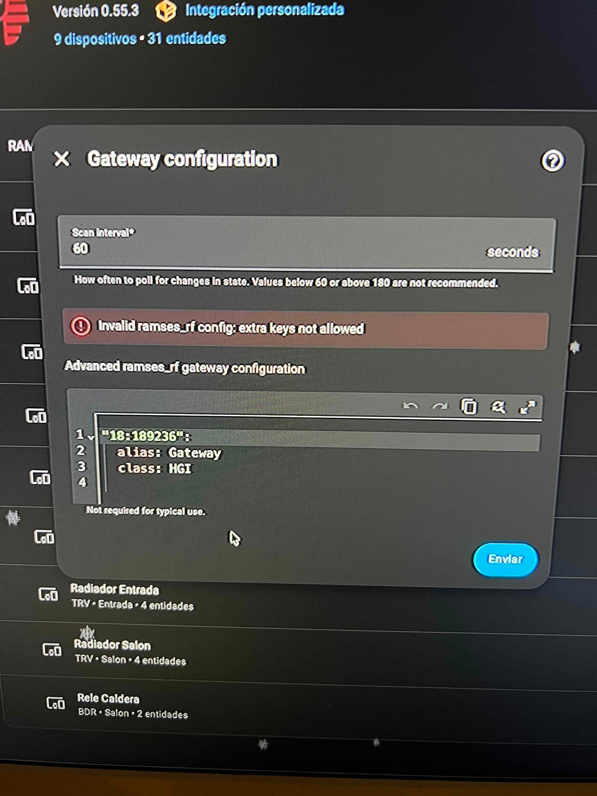

"18:123456":
  alias: Gateway
  class: HGI
123456 = your gateway ID

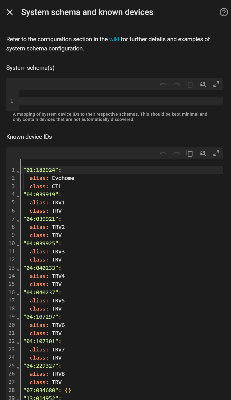

it give this error
what i doing wrong ?
You’re in the wrong configuration section, you want Known device IDs
ok the configuration is correct if i do this ?

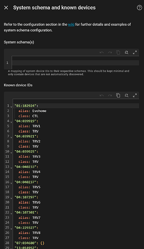

i make the changes now, and now waiting for all the system refresh ?
