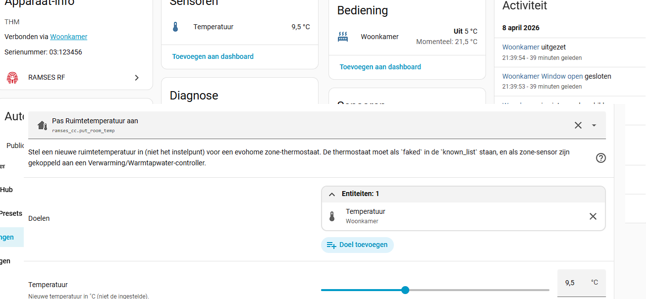

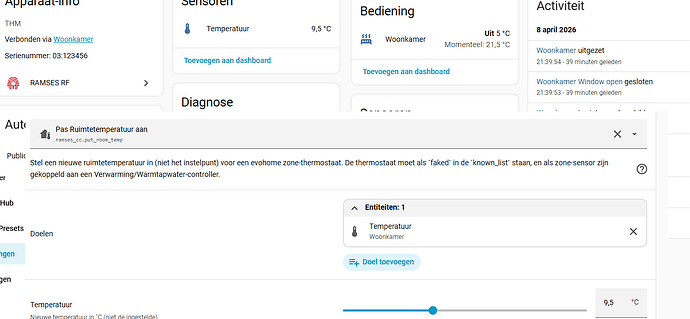

0.56.2 has the same issue. I guess there is progress because I don’t get any more template errors or errors using the put_room_temperature action. Also the faked temperature sensor in Ramses itself does update to the temperature you put there, but the zone temperature on the display or in HA does not change.
On the image: Ramses zone showing 21.5
Ramses faked sensor shwoing 9.5 after performing the put temperature action, also in the image.
