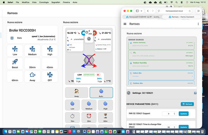

Hi. It seems I’ve been able to handle Ramses (enough for what I need now) and experimented Ramses_Extra. Nice tool. I’m playing with it but I’m having some issue on the Dashboard. The graphic part Reset every hour and give the message “HVAC Fan Card Feature Disabled” - Enable this feature in Ramses Extra configuration. So I have to configure it again to make it work. Than after some time I get same message. What am I doing wrong? Next step is CO2 Fake sensor and Humidity Fake sensor. Where can I read something (I’m using a Tuya device configured in HA which is giving me a lot of parameters and I would like to use them to complete FAN info). Thanks

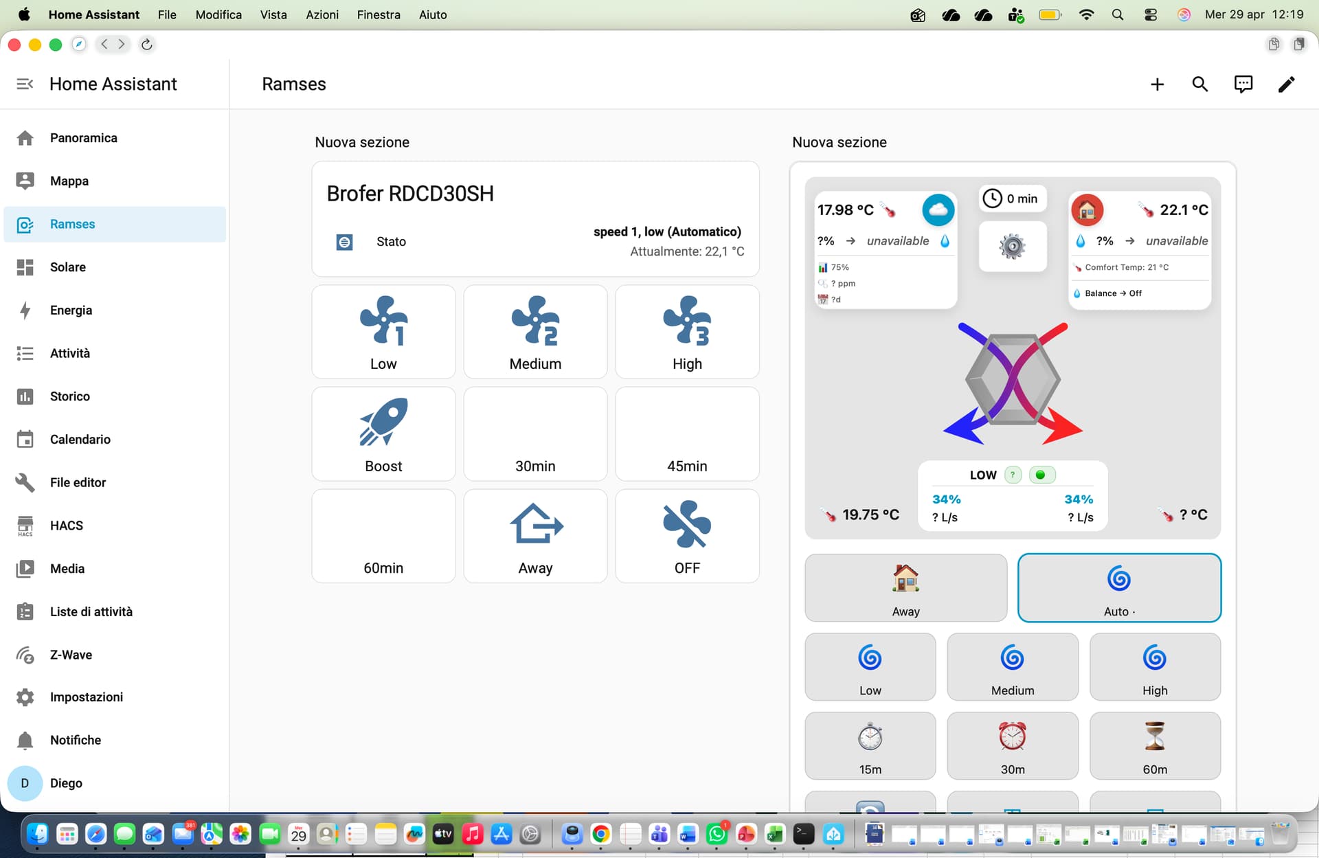

Hi. I found a mistake on my way of configuring (I have followed Claude AI suggestions…).It seems ok now. I’ve added external CO2, Humidity and other sensors but absolute Indoor and outdoor are not showing. Is there some setting I need to do? Also temperature on bottom right is showing “?” and I don’t know what it refers. Also calendar below CO2 in the graphic part is not showing. Some of commands are not matching: when I press “Low” command in the Graphic part is actually setting “Away”. When I press “Medium” in graphic part I get “Low” setting. Any help really appreciated. Thanks
@Vedovatod
Bottom right temp. is the temperature of the air coming into your house (from outside, but heated or cooled by the outgoing air). Possible that your FAN doesn’t have a sensor built-in for it. Check the Supply temperature entity. There is currently no option to redirect this on this position on the card. But you could look at area sensors for now.
Absolute humidity is calculated by the default feature. It’s used by multiple features so that’s why I made it available from there. Default feature is always enabled, but you still need to select the devices it should be enabled for…so enable your fan. But, I think you have done that ?
I noticed you may have selected derived for indoor temperature/humidity. I’m afraid that’s an option I intended to work out, but never did and it should be removed. (I will if time allows it, issue created as a reminder). So, just select external + your entity.
