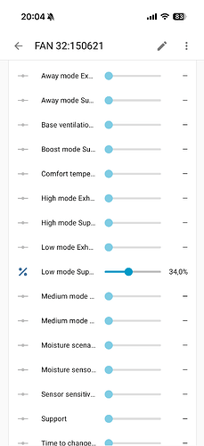

Hi, from last update all configuration possibilities are blocked (used to work with no problem).
Is there something I’m doing wrong? I can adjust Fan Speed.
I can’t tell.
try to run the update_fan_params action from developer tools.
If it persists then please create an issue on github with logfiles and your schema attached .
New version has fixed. Many thanks.

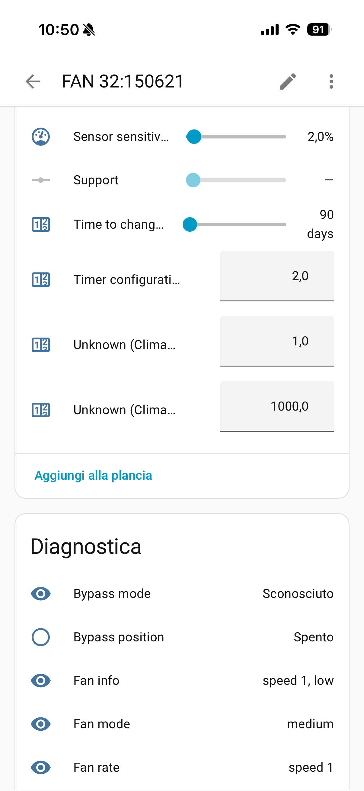

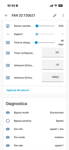

Just curious. What is difference between fan info, fan mode, fan rate?
The information in those entities is not officially defined for ventilation equipment (HVAC).
  • Fan Info: Current fan info displayed on the Climate controller entity in Home Assistant, for example “speed 1, low”. Looks like a combo of the next mode, rate:
  • Fan mode: one value from a list of “modes”, “auto”, “manual”, “boost”, “paused”. Some manufacturers don’t let their fan send this, or use it for the fan speed (“low”) or always send the same strange value “Unknown_0x1F”. Not translated in the UI
  • Fan rate: fan speed step “name”, for example: “low”, “III”. Again, the fan just sends a number and we pick an item from a fixed list. But some manufacturers put a % in here. Not translated in the UI
  • (Exhaust) Fan speed: a number from 0-100% (not sent by every fan). It is in the same byte as Fan rate, you might see 0.1%. In that case, just ignore…
Ramses RF sticks to the English manufacturer’s words.
If you want to display localised (“translated”) words, you can create a template helper.

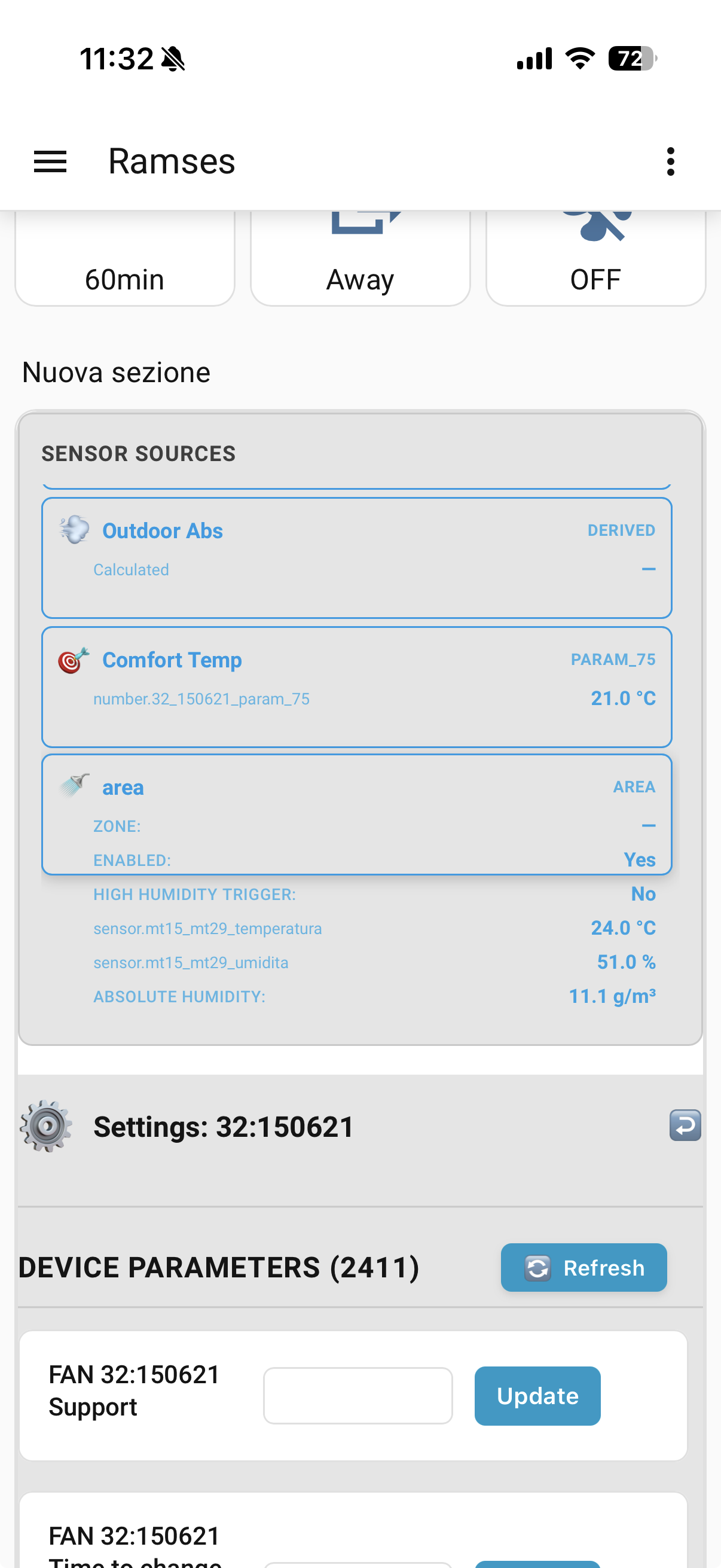

Hi, I’ve been testing several options but still not successful Absolute Humidity. If I use internal sensor, it seems the selection is not saved (every time I try to change a parameter, all internal sensor selection are blank). I have created an absolute humidity helper for internal and external (they are working) but I’m unable to make them work in the dashboard. If I use external sensor, parameter are saved correctly but absolute humidity is not showed. If I check “sensor sources” it says indoor and outdoor abs are calculated, but no value is shown. I can anyhow show un the same screen absolute humidity in blue color. Not sure what I’m doing wrong.

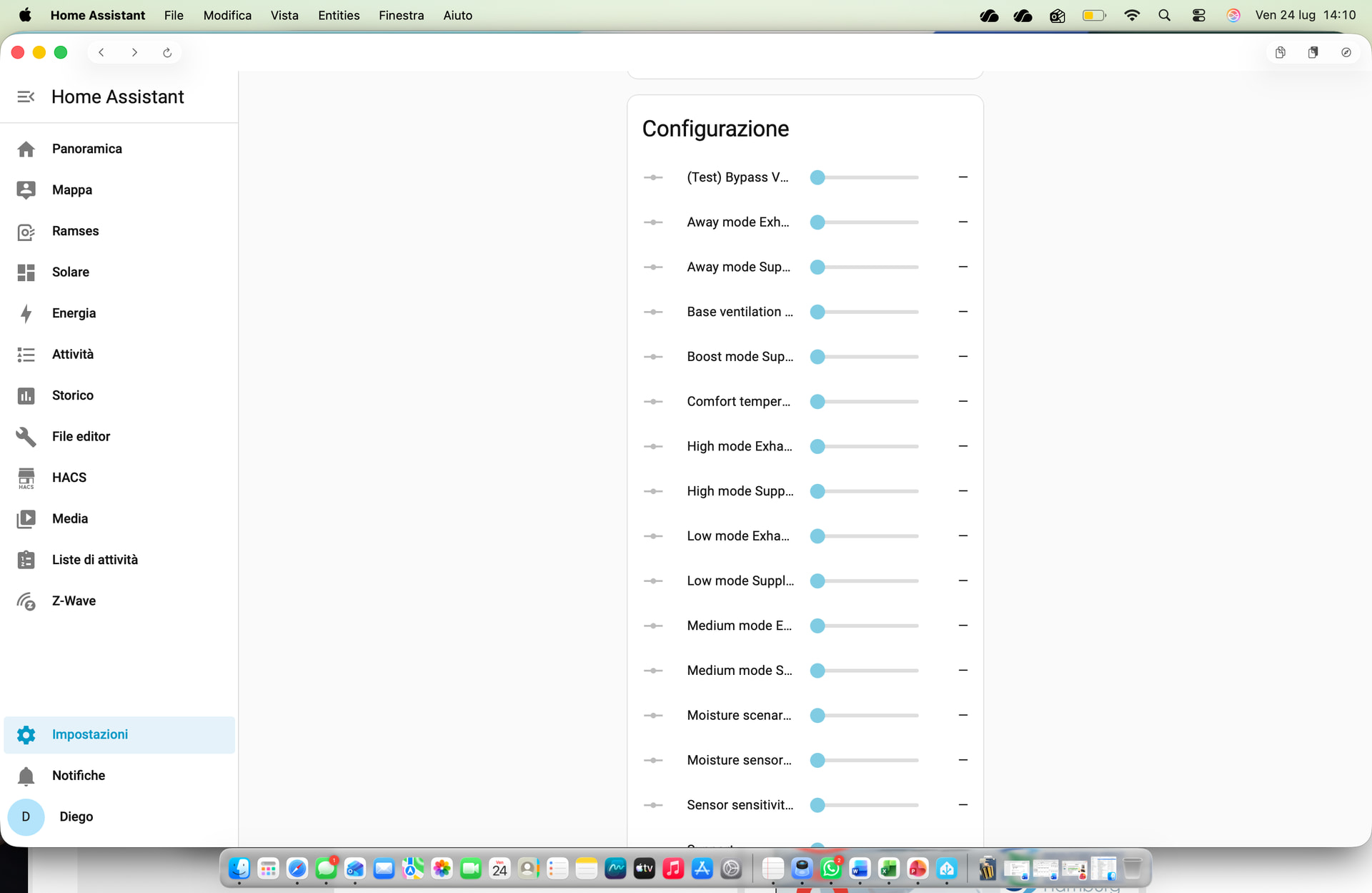

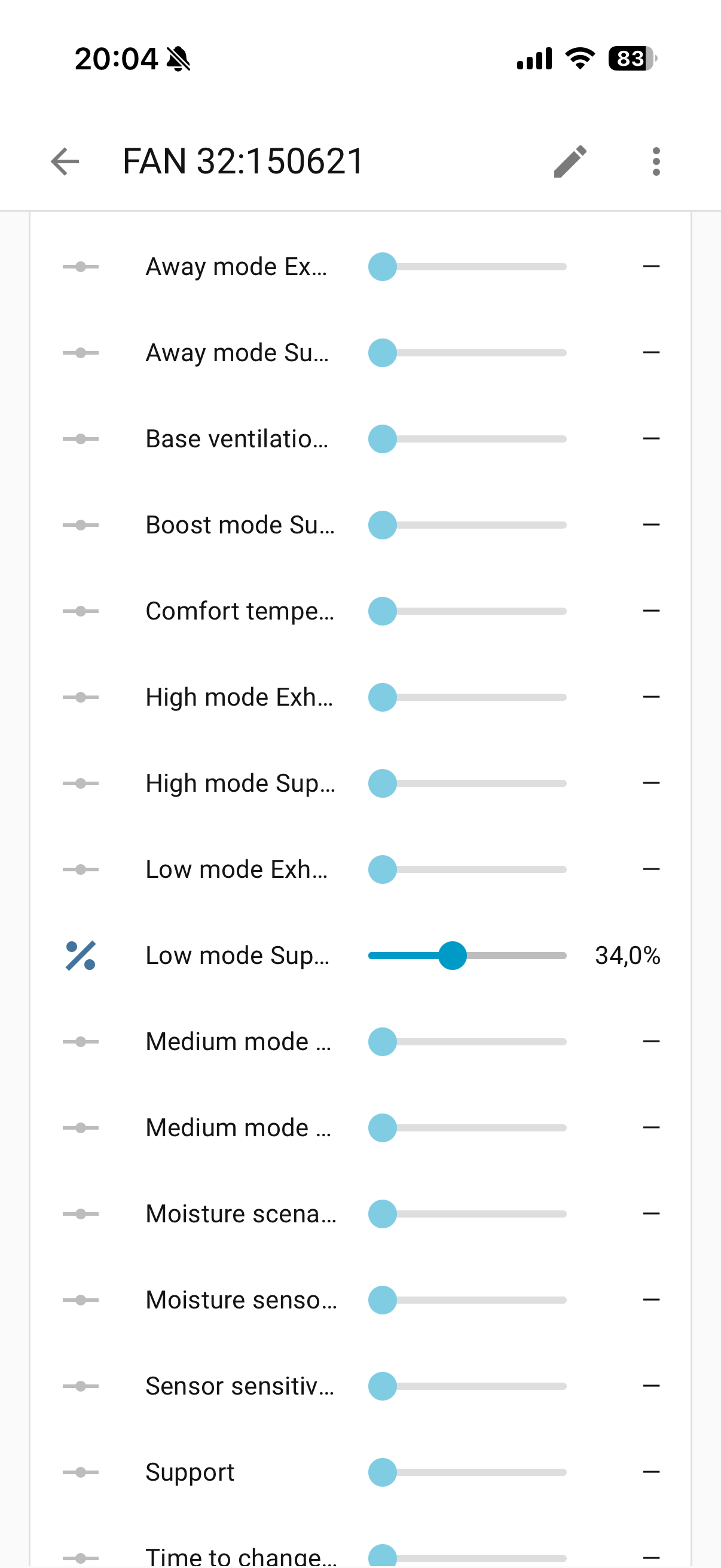

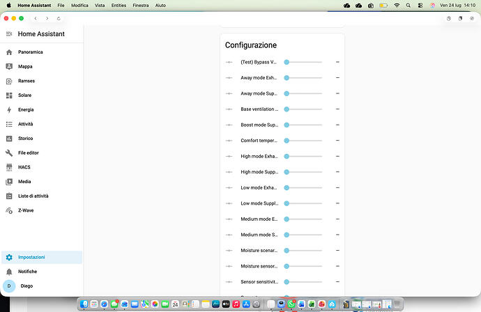

Hi. Just updated to 0.59.3
All working. Several parameters greyed out (they used to works).
