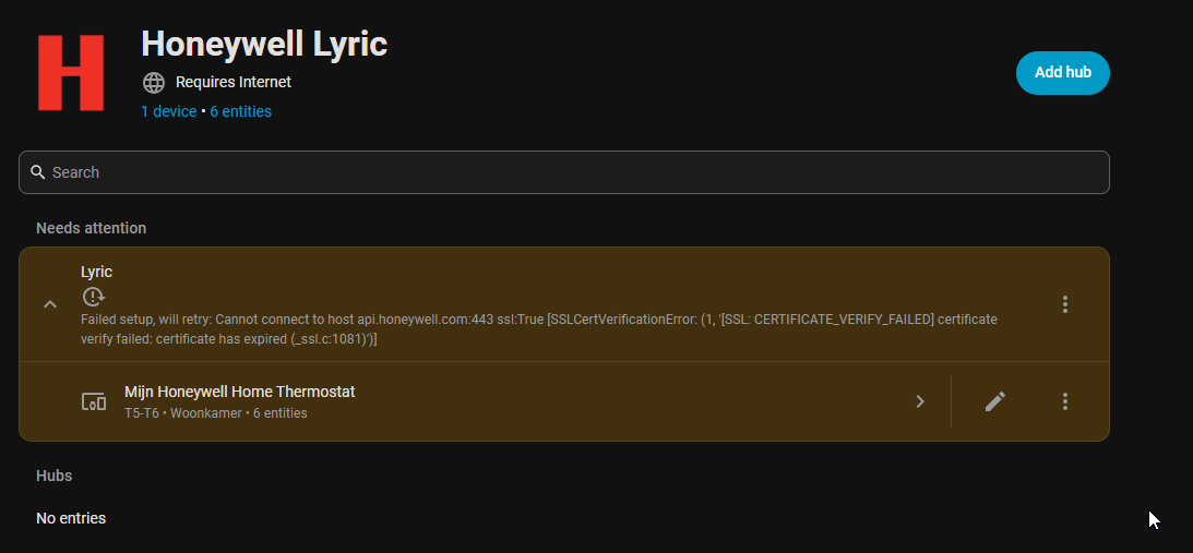

The `lyric` integration is failing with the error below:
```te… xt
Failed setup, will retry: Cannot connect to host api.honeywell.com:443 ssl:True [SSLCertVerificationError: (1, '[SSL: CERTIFICATE_VERIFY_FAILED] certificate verify failed: certificate has expired (_ssl.c:1081)')]

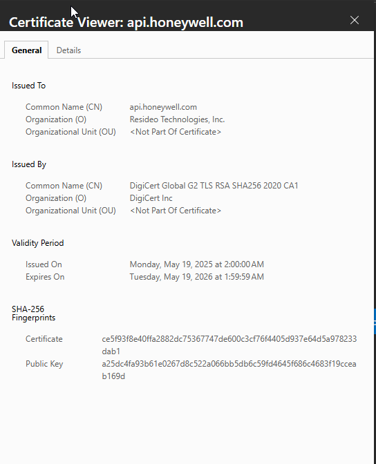

By checking the URL: `https://api.honeywell.com/` we can confirm the certificate has expired:
<img width="521" height="571" alt="Image" src="https://github.com/user-attachments/assets/b6a2b473-d56b-4883-9875-074cce54595e" />
I know this is an issue on their end, but maybe we could have an option to not check the certificate? It's not safe and I hate the option and other options are always welcome.
Or if companies actually took care of their certificates. 🤦

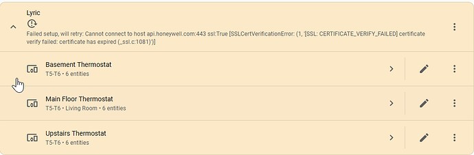

After the update to 2026.5.3 my Lyric integration is still reporting the SSL error. Do I manually need to change the URL?
I would suggest restarting everything and rebooting the host to eliminate caching issues.
If you followed all the directions and it's still a problem, do a new issue and reference the old one.

The problem must be fixed by Honeywell, because the certificate is expired:
You must have not read the fix in the Git issue. Honeywell changed the API URL.
In any event. This is resolved in the 2026.5.4 release.
