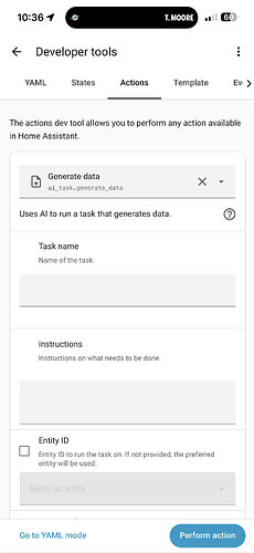

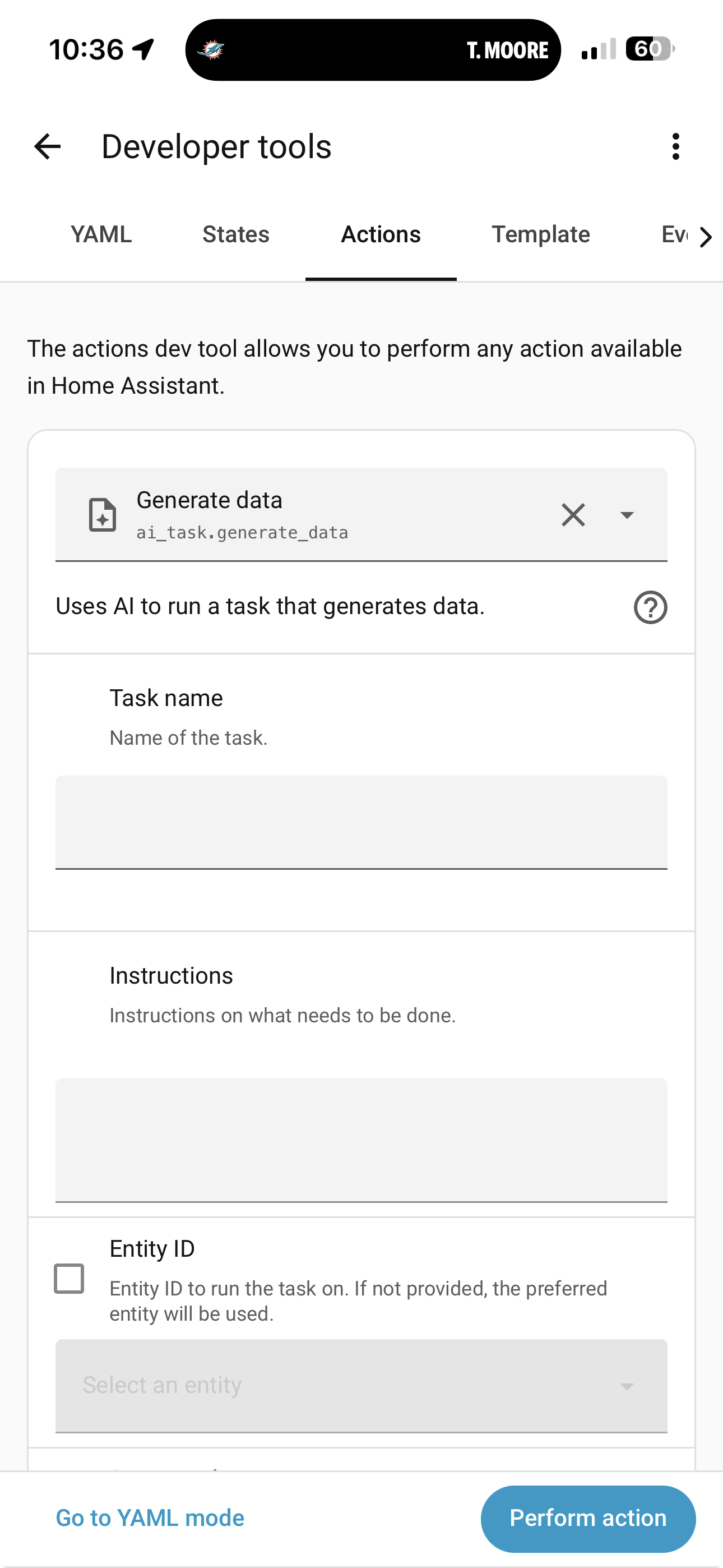

@busman I’m not sure where to add this to yaml in developers tools.
Bottom of your screenshot.
