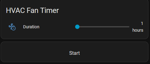

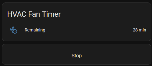

Dashboard:
type: vertical-stack
cards:
  - type: conditional
    conditions:
      - entity: input_boolean.hvac_fan_active
        state: "off"
    card:
      cards:
        - type: entities
          title: HVAC Fan Timer
          entities:
            - entity: input_number.hvac_fan_hours
        - type: button
          tap_action:
            action: call-service
            service: script.hvac_fan_start
  - type: conditional
    conditions:
        state: "on"
    card:
      cards:
        - type: entities
          entities:
            - entity: sensor.hvac_fan_countdown
        - type: button
          tap_action:
            service: script.hvac_fan_stop

Altogether this gives me the ability to manually run the HVAC fan for 1-8 hours, display how long is left until it stops running, and the ability to stop it early if I need.
