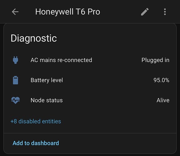

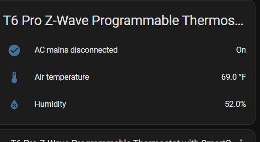

I get this as part of the menu when I added the T6 to HA Green. What does this mean?
AC mains disconnected.
It means it is running on battery only. Likely because you joined the zwave network while it was not connected to the mount therefore powered by mains.
Remove the device from the zwave network. Make sure it is mounted and powered then reconnect it to the zwave network.
I removed it and added back, and it came back and it’s only on 24v. It’s a different issue and Honeywell says this dashboard entity is not in their database.
binary_sensor.t6_pro_z_wave_programmable_thermostat_with_smartstart_ac_mains_disconnected
I have that sensor on my T6 it is off because I have it powered by 24vac. Recheck your wiring.

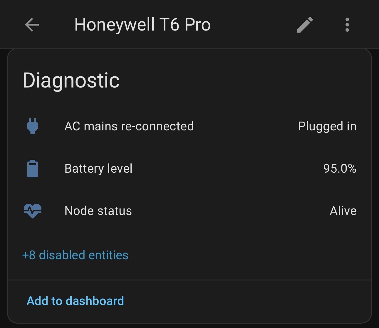

Yours says it’s off and it’s connected to 24v AC? Mine says plugged in. I just don’t understand the sensor.
My sensor is ac mains disconnected.
Anyways, your sensor indicates that your device has 24vac power. If you turn the 24vac off (usually by turning the furnace emergency switch off) then it should report the device does not have power.

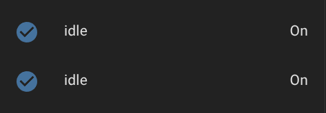

There is a bug (regression) that was introduced some time in the summer (I haven’t had time to write up a proper bug report) and states that are intended to be skipped are still generating entities.
E.g. these “idle” sensors (idle state 0) that were created for a smoke alarm should not exist.
