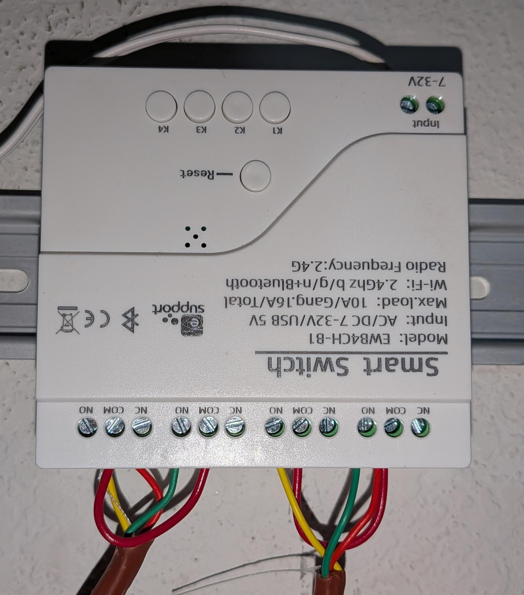

I’m using a 4-channel switch because I wanted to be able to run both zones of my AC/Furnace in fan-only mode and add a time-based option for each one of my AC units (rather than relying on the thermostat alone). I’d purchased this one because it was advertised as a Sonoff Zigbee device, but - even after sending it back to have it swapped out for what I actually ordered - I ended up with a WiFi version :frowning:
I’d previously used a one-channel relay combined with a temperature sensor for about 10 days when my thermostat died (that’s how long it took to get a one-for-one replacement), so I knew I could do this for the AC part of my setup.

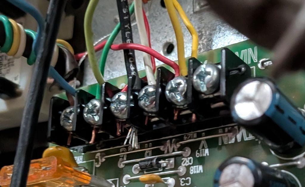

To connect the AC/Furnace units to the switch, I simply added a 2nd thermostat wire to each one of the main boards:
There is a standard of which color is supposed to run which function of the AC/Furnace, but it’s probably best to google that.
And this is what the wired-up 4-channel switch looks like:

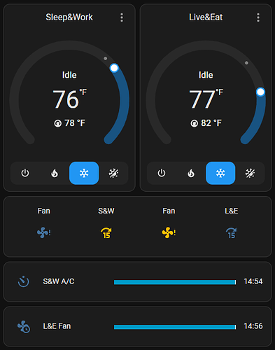

Some of the necessary logic, e.g. don’t allow the AC to be turned on within 5(?) minutes after it has been turned off, to avoid damage to the AC units seems to be built into the AC/Furnace unit itself, so I didn’t have to account for that in my automations/scripts. :+1:
Right now, I’m just using 15min timers to initiate the fan-only and temperature-override actions of the thermostat-driven activities.
