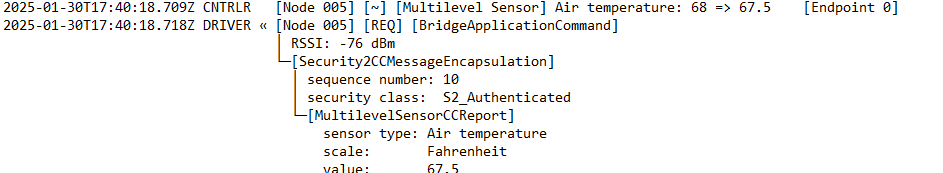

The driver logs are fairly clear but I went well back in time and never see it sending something that corresponds to operating state, at least nothing that said heating. The last one was this:
And that’s 5 hours ago. It seems like the controller is not requesting the state?
Yet I see plenty of other items:
That’s fairly current (maybe 4 minutes before I pulled the log). But there’s no request of state I can find.
Could it be that for some reason the zwave-js issue and it’s not requesting the data so it’s just reflecting what it last requested?
Despite the refresh request (that said it completed successfully).

I’m confused then from the log, that first one I posted looks like the controller sent a request for operating state? That’s just a guess from the CNTRLR followed by what appears to be a response including the state.
I’m going to update the rPi that runs zwavejs (and -ui), then upgrade that docker (it’s one version behind I think), just to see if anything changes, then will try a refresh with more careful timing. I have 27 devices so it’s a busy log. More in a bit.
There’s nothing in your screenshot that indicates the controller made that request. The log is truncated so it’s not possible to see from my POV. It could just be the device reporting it the change once the heater has turned on, which would be normal. The device is reporting Heating, if that conflicts with what you see in real life, the problem is with your device.

2025-01-30T18:49:12.648Z SERIAL « 0x010401a90152                                                       (6 bytes)
2025-01-30T18:49:12.697Z CNTRLR   [Node 005] [Multilevel Sensor] Humidity: metadata updated         [Endpoint 0]
2025-01-30T18:49:12.706Z CNTRLR   [Node 005] [~] [Multilevel Sensor] Humidity: 38 => 38             [Endpoint 0]
2025-01-30T18:49:12.714Z DRIVER « [Node 005] [REQ] [BridgeApplicationCommand]
                                  │ RSSI: -76 dBm
                                  └─[Security2CCMessageEncapsulation]
                                    │ sequence number: 49
                                    │ security class:  S2_Authenticated
                                    └─[MultilevelSensorCCReport]
                                        sensor type: Humidity
                                        scale:       Percentage value
                                        value:       38
2025-01-30T18:49:12.718Z CNTRLR « [Node 005] received current Humidity sensor reading: 38 %
2025-01-30T18:49:12.721Z CNTRLR » [Node 005] querying battery status...
2025-01-30T18:49:12.763Z SERIAL » 0x011c00a9000100050e9f031f00cac16fcf44254558431f2500000000563b      (30 bytes)
2025-01-30T18:49:12.766Z DRIVER » [Node 005] [REQ] [SendDataBridge]
                                  │ source node id:   1
                                  │ transmit options: 0x25
                                  │ callback id:      86
                                    │ sequence number: 31
                                    └─[BatteryCCGet]
2025-01-30T18:49:12.784Z SERIAL « [ACK]                                                                   (0x06)
2025-01-30T18:49:12.790Z SERIAL « 0x010401a90152                                                       (6 bytes)
2025-01-30T18:49:12.793Z SERIAL » [ACK]                                                                   (0x06)
2025-01-30T18:49:12.801Z DRIVER « [RES] [SendDataBridge]
2025-01-30T18:49:12.952Z CNTRLR   [Node 005] [~] [Battery] isLow: false => false                    [Endpoint 0]
2025-01-30T18:49:12.962Z CNTRLR   [Node 005] [~] [Battery] level: 95 => 95                          [Endpoint 0]
2025-01-30T18:49:12.974Z DRIVER « [Node 005] [REQ] [BridgeApplicationCommand]
                                  │ RSSI: -76 dBm
                                    │ sequence number: 50
                                    └─[BatteryCCReport]
                                        level:  95
                                        is low: false
2025-01-30T18:49:12.978Z CNTRLR « [Node 005] received response for battery information:
                                  level:                           95
2025-01-30T18:49:13.000Z DRIVER   all queues idle
Should I be concerned about the “one or more queues busy” right at the top?
Also, I’m mixing terms up. The HA state is the HVAC Mode, which is off.
The HA attribute “hvac_action” is what is wrong, it should be idle but is “heating”. I think this is a state in the zwave log but I am unsure of that.
But the thing that is wrong is not HA state, which updates instantly, but “hvac_action” attribute.
I’m not sure what you’re refreshing exactly. It should just be the Thermostat Operating State, which is a single value. There shouldn’t be so many commands for this.
That button, but for the Thermostat Operating State v1 panel.
I used the zwavejs-ui’s advanced, refresh option. Sorry.
The one you indicate worked and shows “Idle” now.
So… does this mean I just missed an update (or it didn’t send one) and over all that time nothing updated it, including the advanced-option-refresh?
Is there some HA side thing I should do periodically to make sure I’m current, the equivalent of that button?
2025-01-30T20:45:33.519Z CNTRLR   [Node 005] [~] [Thermostat Operating State] state: 1 => 0         [Endpoint 0]
2025-01-30T20:45:33.531Z DRIVER « [Node 005] [REQ] [BridgeApplicationCommand]
                                  │ RSSI: -77 dBm
                                    │ sequence number: 74
                                    └─[ThermostatOperatingStateCCReport]
                                        state: Idle
2025-01-30T20:45:33.545Z DRIVER   all queues idle
2025-01-30T20:45:59.122Z DRIVER   one or more queues busy
No, I don’t think you should. Whatever being reported from z-wave should show up in HA.
And based on the screen dumps in your first post, looks like this specific z-wave thermostat is reporting “Heating”, so your HA is picking that up correctly, based on what the T6 (via z-wave) is telling HA.
So sounds like there is something going on, somewhere between T6 and z-wave.
Just an idea: Have you considered excluding the T6 from z-wave js ui, and re-include again? Could it be something due to incomplete interview?
I would expect that to work too, just with all the extra noise. If that’s not working properly, you’ll need to get assistance from https://github.com/zwave-js/zwave-js-ui.
That’s really impossible to answer from here. Could be any of those, or even that your ZUI was offline during that time.
If it’s critical to have this value at all times, then you can poll it manually with an automation. https://www.home-assistant.io/integrations/zwave_js/#my-device-doesnt-automatically-update-its-status-in-ha-if-i-control-it-manually. The automation route gives you the flexibility to implement it as you like, e.g. on a time schedule, when the entity state changes, when HA starts up, etc.
If you do implement that with the refresh_value service, be sure to set attribute refresh_all_values: true and use the climate entity so it includes the operating state, but this includes everything else related to that entity too (so extra noise). ZUI itself also has the ability to do polling in its own configuration, so you can just poll the operating state value directly.
I haven’t. I could of course. But all other attributes, both innate (e.g. ambient temp) as well as pushed-down (set points for example) are updating near instantly. So far it’s just been this.
What’s odd about this is this started in the wee hours this morning on three of these at once. The other two reset by just cycling through modes (from their front panel), but not this one.
There was no event I could see this morning - HA was up continually, as was the ZWave box, power was unchanged, heat was turning off and on all night as normal. I run a network monitor as well as SNMP polling of UPS’s, so I would see most glitches (not zwave loss unless it lost the entire device).
Is it critical? I can probably program around it. The NodeRed flow uses the knowledge whether that zone is currently heating (or cooling) to know whether to apply a hysteresis to deciding if it should turn that zone on or off. Because it was incorrectly deemed to be heating, it did the turn-on about 1.8 degrees too hot, then fairly quickly turned off, short-cycling that zone badly but also keeping it too hot. I can rewrite the flow to let the state “Off” (not hvac_action) signal it is idle even if the action says otherwise. But… it makes me worry if I’m missing other attributes or state updates.
The zwave stick (Zooz 800 LR) is in a Raspberry Pi 3B, so it’s running on kind of a wimpy computer. Is there any chance I’m reaching some limit and it’s not keeping up? As things go it’s probably not a large network, but there are a couple dozen devices on it, some probably kind of chatty (most are sensors of various sorts).
A dedicated Raspberry Pi3 is plenty powerful enough to handle a Z-Wave network which operates at a maximum of 100kbit/sec.
If the Pi is not dedicated, then it would entirely depend on what else is running on it.
Is it a combo stick or a dedicated stick? I’ve noticed with my combo sticks (which I’ve been replacing on my various HA instances) that if either the zwave or the zigbee side are having communication issues with their respective mesh that it can cause the other side of the stick to not respond well (which is a big reason for my working on separating the controllers)
You might consider doing a full system restart of HA to get the controller device to see a power cycle and possibly clear out anything gumming up the firmware. I’ve found that sometimes helps. Alternatively, just do a restart of your ZWave-JS UI add-on which will do a warm restart of the device.
The rPi is dedicated just to a docker zwavejs-ui instance.
The stick is only being used for z-wave (I don’t know if it has other capabilities or not, I didn’t think so).
I did notice it was USB 1.1 but even then, these updates are fairly low volume.
All of that was done with no change in this particular problem, all the way down to restarting the HAOS VM, as well as the rPi and docker. The latter were also power cycled not just restarted.
The only thing that made a difference was doing that refreshs on the inner part of the zwave entry (not the top level). Since the latter is more chatty it made me wonder if I was somehow missing pieces of the update for some reason.
