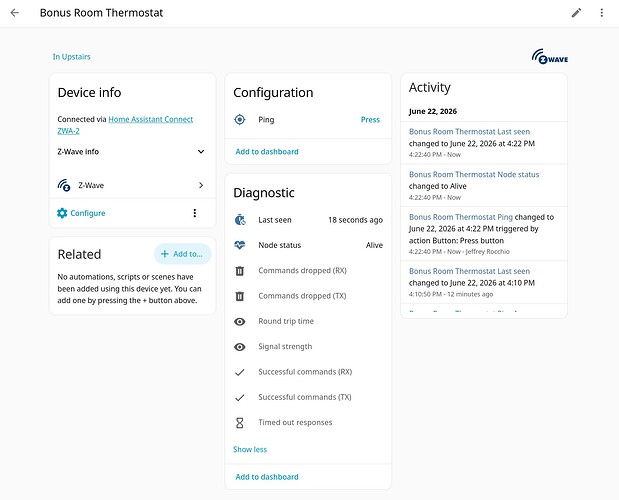

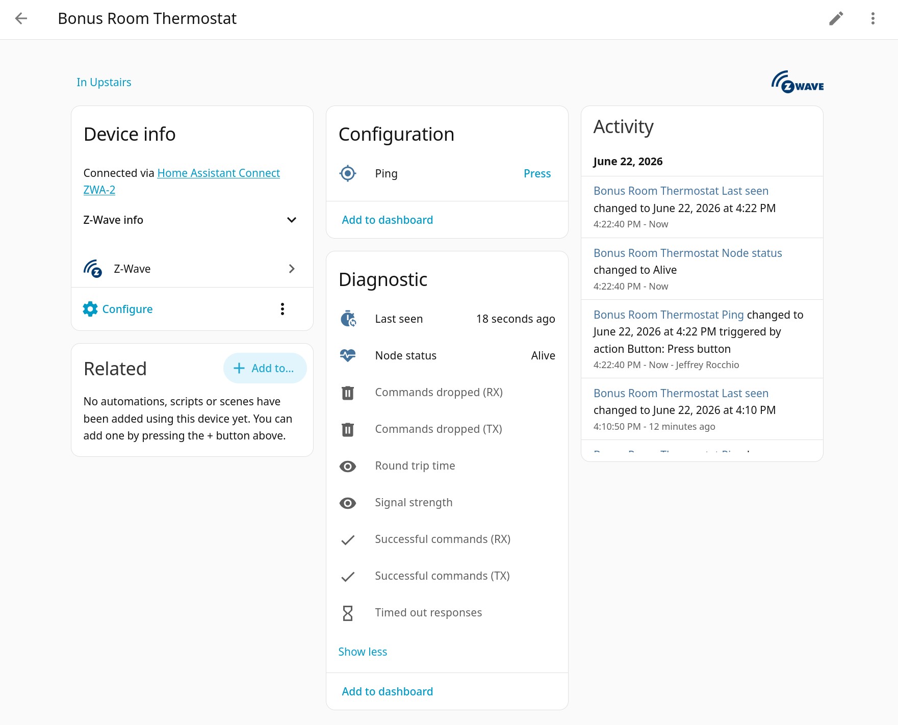

I am jealous! Mine wouldn't permit z-wave setup on batteries alone, said I had to connect to the 24 volt power. Hours and hours today - HA sees it; but only 10 entities reporting and all those are related to the Z-Wave comms (commands received, commands dropped, etc). No entities reporting on anything having to do with actual termostat functions.
I've also been trying to figure out if it has to do with the fact that I don't see or have any indication of having the 'Climate' domain. I look for the 'Climate' integration and it tells me it only gets installed by other modules and integrations.
fwiw, here is what I see in the z-wave device page for the thermostat:
Yeah - I did do all that. I would like to also note that I cannot now 'Exclude' the thermostat from the Z-Wave network. It just keeps telling me that the exclude failed. And, btw, the thermostat is in the same room as the z-wave antenna/hub device - which is the Home Assistant Connect ZWA-2. So not a signal strength issue.
