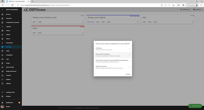

Can I get someone to help me figure out why I can’t get my esp8266 to install firmware from esphome. I also tried to install wled on them as a side test and couldn’t get that to work either. They are being recognized by windows and popping up the serial port selection window when attempting to flash esphome and wled.
It should also be noted that I have multiple of these and can’t get any of them to take a flash in esphome when hooked up to my windows laptop.
Then flash works properly when hooked up directly to my hassio instance on a raspberry pi.
When I hit “new device”, then connect, then select the com port from the windows menu, it shows connecting spinning and then bounces right back to the dialog box of “skip this step” and “connect”

and if I choose “Plug into this computer”, I get “failed to initialize”

It sounds like you are running Home Assistant on the Pi.
  1. In the ESPHome editor, click on Install and select Manual download:
Manual Download
  1. Next select the Legacy format:
Manual Download Legacy
When the code is compiled the .bin file will be in your downloads folder.
  1. In the ESPHome Flasher, select the serial port that the ESP is plugged into.
  2. In “Firmware” browse for the .bin file that was compiled above.
  3. Click on Flash.

Thank you so much @stevemann, I spent so much time on this and you made it so easy. I wish I could get the selection “plug into this computer” to work properly but this will get the job done. Thank you so much for this again @stevemann.
So from here, will I be able to upload new code wirelessly?
EDIT: I have updated the code wirelessly now.

This only works if “this computer” is the one running HAOS. In this case your Pi.
Now you’re in trouble.
This is how I copy a working device code to a new device. It may not be the best way, but it works here. The key is in the substitutions: block. This way you only have to change ONE LINE of the code if the devices are similar. (I have posted a sample of one of my YAML files, below). In my example YAML file, look at how I use $(device_name) in all of my name: and device: blocks.
  1. First, click on “Edit” for the existing device YAML file.
  2. Copy the contents.
  3. Go into the ESPHome page and click on “New Device”.
  4. Click on “Continue” (I don’t even know what ESPHome Web is).
  5. Give the device the name of your new device then click on Next.
  6. In the Select your Device Type, it doesn’t matter, just click on “Next”.
  7. You will get “Configuration created!”. Click “Skip”.
  8. Your new device will appear on the ESPHome control panel. Click on “Edit”.
  9. Delete EVERYTHING.
  10. Paste the contents that you copied in step 2.
  11. In the substitutions: block, change it to the new device name.
  12. Click on “Install”, “Manual Download”, “Legacy Format”
That’s a lot of steps, but once you have done a couple, you can do it in under a minute from memory.
Since this code is new to the device, you have to manually upload the .bin file as described above. Subsequent uploads can be done wirelessly.

Ahh, I understand. I thought that was what the third option was for: “Plug into the computer running ESPHome Dashboard”-- I got this one to work with the ESP8266 hooked up to the pi.
I was under the impression, “Plug into this computer”, was for my laptop. (I connect to the pi headless through my laptop. Nonetheless, I have it running from my laptop with the method you taught me. I am very appreciative of that. I spent so many hours yesterday being an idiot until you taught me the best way.

EDIT: Maybe related?
EDIT2: So I ended up getting this working by following the method of putting all properties under “esphome” like the original was. This is confusing to me though because the 2, 2 line sections were generated by esphome for me so I don’t understand why they wouldn’t work as they are but here we are.
Works (no platform error and can validate):
esphome:
  platform: esp8266
  board: nodemcuv2
Doesn’t work (i.e. platform error):
esphome:
esp8266:
  board: nodemcuv2
