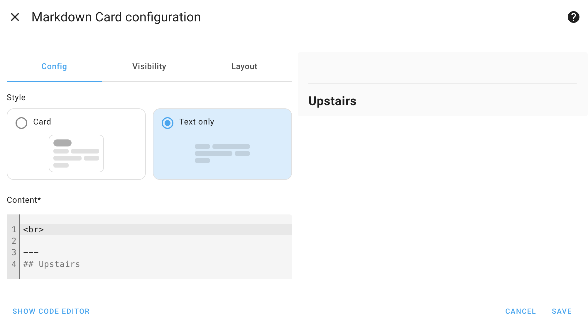

This is possible with a Markdown card. Enter three hyphens ---.
You can also use <br> to create a line break before/after if needed.
Greg, thanks for the pointer to the markdown card. I tried it and indeed, you can put in a horizontal line, but there were problems with it. The card doesn’t seem to follow the cheatsheet it quotes. For example, it puts a very dim horizontal line surrounded with a border in the ‘card’ config. Using the ‘text’ is better, but it is still so dim it doesn’t really separate anything.
In the cheatsheet quoted, you should be able to get a bold horizontal line, but every attempt that worked in the cheatsheet example failed in the markdown card.
I can’t put examples here because the markdown interpreter keeps getting in the way. It looks like almost every implementation of markdown has quirks.
Plus, the markdown card interferes with the UI editing. Suddenly the little pencils that show up on cards for editing go away, and when you click on the card, it appears for a half-second and the goes away. I got pretty good at doing a double click to catch that pencil before it disappeared.

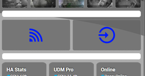

I use an empty entities card to create the white spacers. Not exactly a line but it works for me.

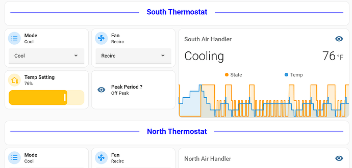

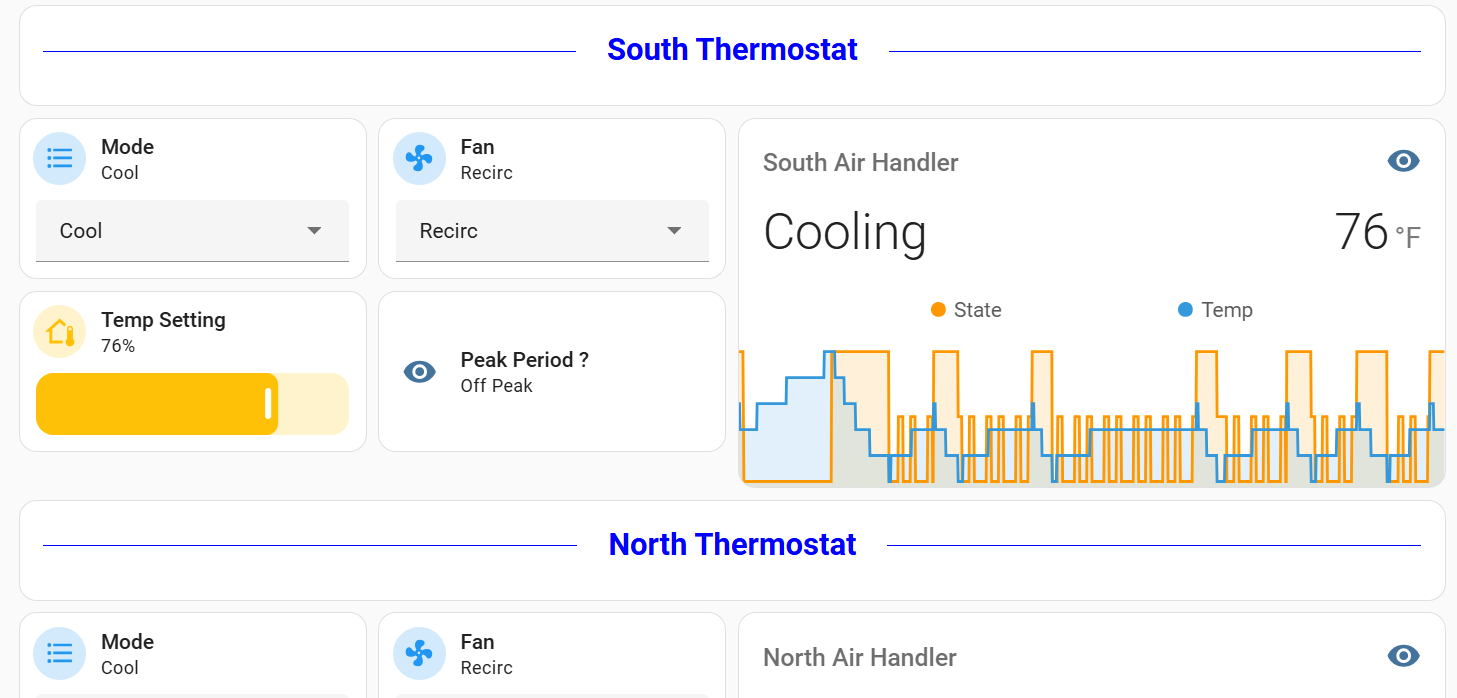

That GOT IT !!
However, I had to remove the header card from the section and replace it with the Text Divider Row to make it look right.
Doing the same thing with the divider worked also, but I was able to put the name in the middle of the line with the custom one.
Progress, Thank you.
By removing the header card and replacing it with an entities card and making the entity a text divider row, I was able to get some color into it using card mod. Now, the two AC control and information sections can be told apart. I also kept most of the UI working. I still have to edit YAML for the heading, but the rest of it is great.
