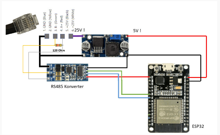

Are there any like plug and play solutions for the Supramatic E2?
Check the github I updated the example yaml.
Buy a an E4 motor and a board from tynet:-) As fare as I know for the E2 only the Relay option is working. Check the google document in previous post there is an example with reed sensor the get feedback if door is opened or closed.

I already have a device connected to the RJ12 port, controlling the door using a humidity sensor. Is there a possibility to use both?

if you use one of my tynet PCBs it should be possible.
