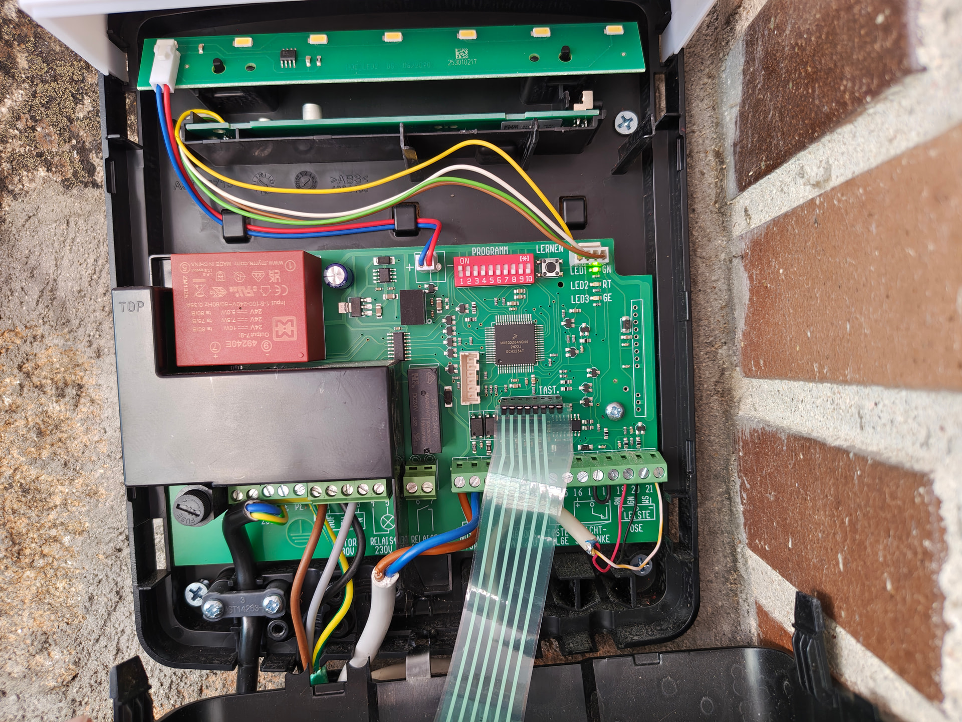

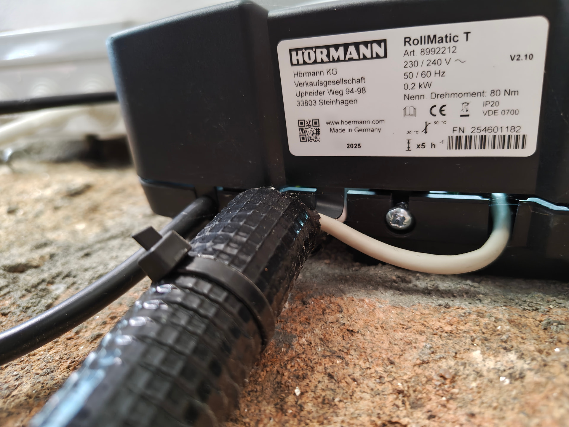

I have a Horman Rollmatic T v2.10 controller/port just installed. Console manf date is 2025. So pretty recent.
Do you think I can use your device with my door?. I can't really manipulate the roller box. I only have (easy) access to the console with the 2 buttons.
Many Thanks.
JC
not sure, i can't see any BUS POrt on it, without that it will not work. You can have a look into the instructions from your door and search for the BUS Port, it will show where it is on the motor if avaliable.
This is a pic of the board. I do not see the bus...unless hidden in the black box.....
maybe I can use the "TASTE FOLGE" contacts with a rele and an esp32 ?? ??
So with that it has no BUS Port and can't be controlled by my board sadly.
You can maybe use on of the contacts with a relay to control it somewhat, but not in an intelegent way like with the HCP Bridge over the BUS Port.

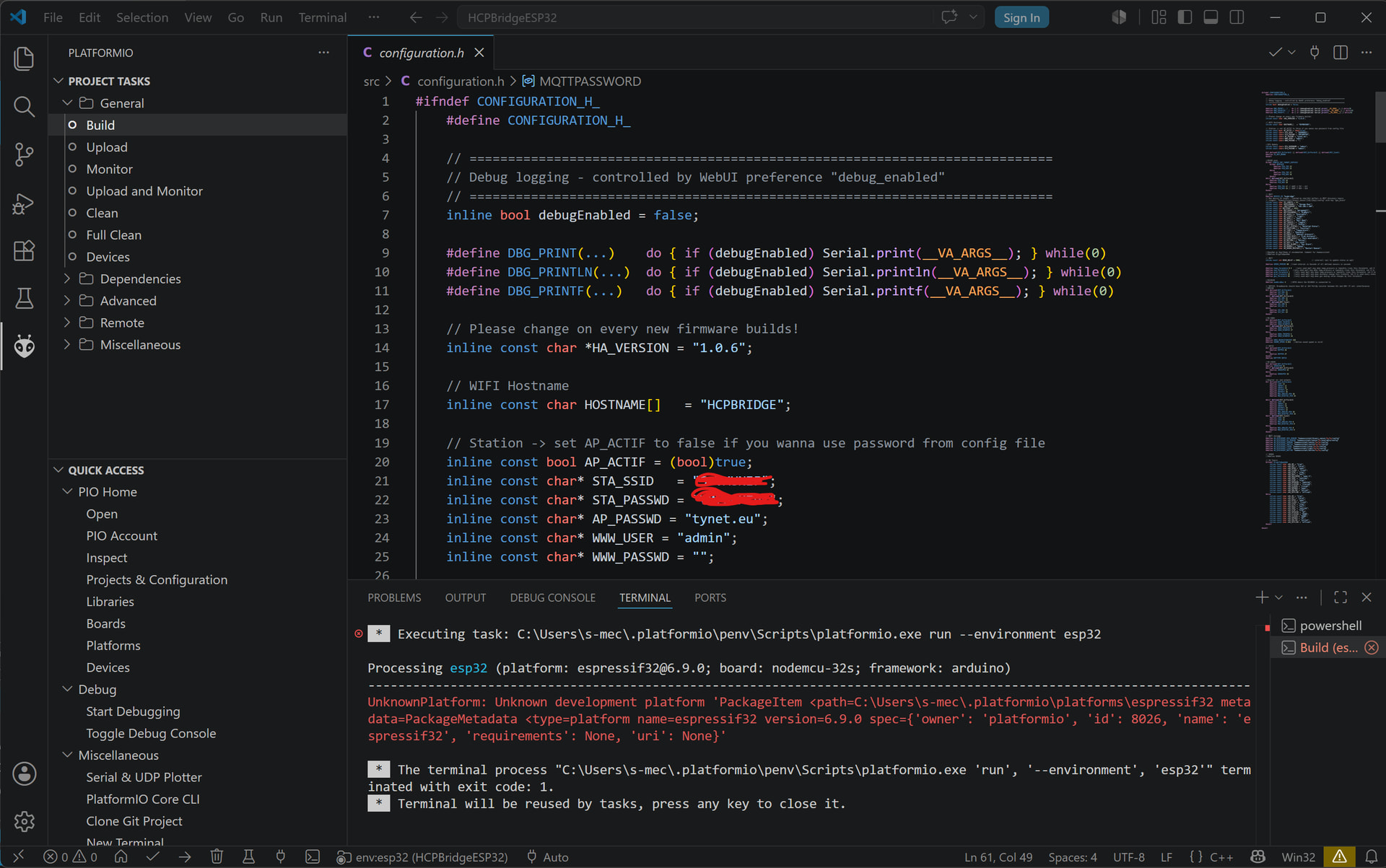

Wondering what I am doing wrong with flashing my ESP here? I was going to use the Gifford47 version and hit a problem, posted as a bug (my bad) and was advised i needed to use the platformio plug in - which i thought i was doing (no experience at all in VS Code so am finding my way by trial and error).
When searching the completed issues on that project I discovered this ESPHome version which will suit me better for home assistant, but i hit the same error when building firmware. Where am i going wrong with this, am i using the wrong bit in the VS/Platformio interface?
If you bought one of my tynet.eu boards just use one of my prebuild firmwares and flash it over my website:
No its not a prebuilt board (apologies!) - i am going down the DIY route. Guessing i cant use the online flasher as there's nothing on there to start with? I didnt even try to be honest for that reason..
Update - i had a plaformio install corruption. Reinstalled, but i still have build problems! Gifford47's is now building ok, so i will keep trying and see what i can figure out as an esp32 option is my preference now i know there is one...

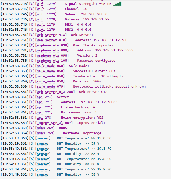

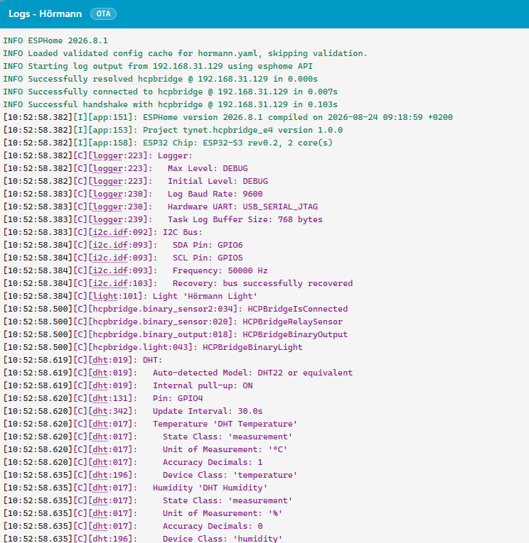

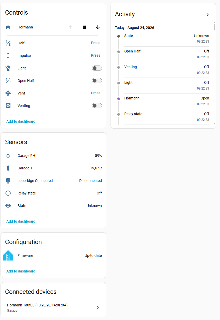

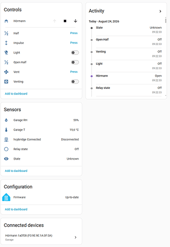

My board is working just fine. However. Very often, the state of the board published is “unknown” , the hcpbridge is marked “Disconnected” and the board cannot be controlled over HA anymore. In ESP Home it is still marked as “online” and it can still be updated. So it must indeed be online. After a power cycle, the device is reported again as “connected”, the hcpbridge is marked “Connected” and it can be controlled remotely again in HA.
The temperature and humidity over the DHT22, keep on updating tough. The phenomenen seems to be limited to the HCPbridge only. Strange.
Has anyone this same (or similar) situation. Can anybode pinpoint what is happening here?
The device in HA:
The status in ESP Home:
Result of the logs, while the unit’s status is “unknown” and the hcpbridge is marked “Disconnected”:
