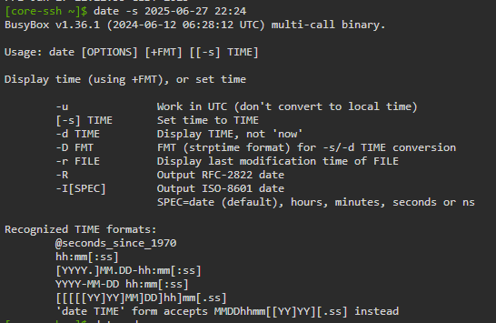

I tried in ssh add-in on Homeassistant on Raspberry PI, but get the following error.
How to use bash? And is bash required to be able to set the date?

This is with the official ssh server add-on.

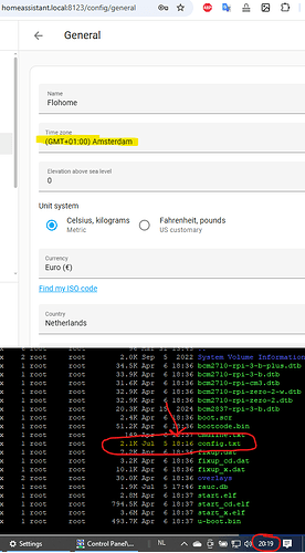

I thought maybe the wifi adapter of the raspberry pi is seen as second NIC, although I don’t use the wifi and it is not configured, I read elsewhere that multiple NIC could be giving problems.
So I disabled the wifi adapter through editing the config.txt file.
But even after reboot this was to no avail.
After setting the config.txt file back to what it was I noticed the timestam was 2 hours off(18:16), while my time was at the moment GMT+1 Amsterdam DST(20:16)
I can imagine that the Host OS is in Zulu time(18:16), but I miss an hour of the DST(day light saving time).
