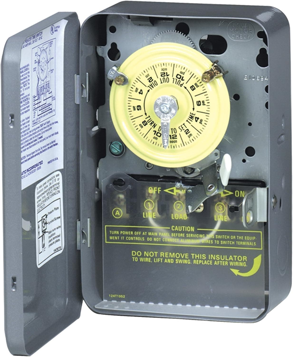

The thing that is being replaced is Intermatic WH40 Electric Water Heater Timer, Gray - Wall Timer Switches - Amazon.com
It isn’t this, but it should give you an idea. The one we had, for some reason the wire started smoking. We are going to be looking at that more later this week to see the cause. But I’m assuming the timer needs to be replaced. And I figure if we are, then we might as well look at something that works with home assistant. At best we get something we can remotely turn on/off the heat. At worse we stick to something like this.
All the features something like this has to be there. (local timer settings, manual control, etc)

That mechanical timer you show is rated to switch 40amps. You will need a suitable contactor to switch that load if you automate the smart alternative.

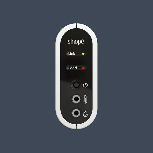

I'm browsing around and looks like we have zooz zen78 these days. Didn't know until now.
That's what I was going propose. I bought two but haven't deployed them yet.
