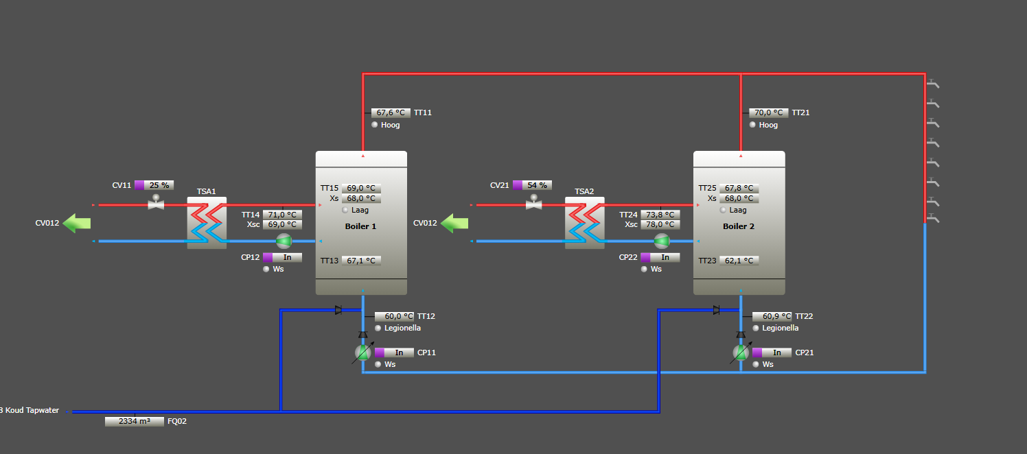

Just for reference: At the hospital I work, we even use recirculating waterlines, so that water in all pipes thru the building never stand still. Good against sediment and necessary to fight legionella.
We have a 23 hours long setpoint of 60 C in the tanks, and middle of the night we even have 1 hour of 75 C setpoint, which ensures, that all pipes in the building get theirs 60 C for 30 minutes. We need to be sure, that not the exit temperature of the tank is 60 C, but the return water after the travel thru the house must be 60 C.
Yes, that would probably be a bit overkill for a regular house. I'm just giving a perspective... :wink:
Just for the curious ones, here an example of a hygienically safe and redundant warm water installation. I do maintain 12 of such sites... :wink:
