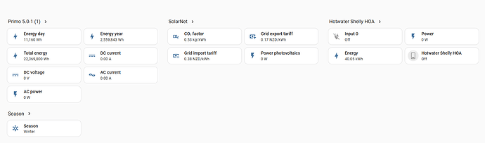

I am new to Home Assistant and I could really use some help with my Fronius Inverter and Shelly (attached to my hot water cylinder)
I want to use my solar to heat up my hotwater cylinder above a threshold. The hotwater Cylinder has a 3kW element.
My criteria are:
  • Check if Shelly needs power to avoid a constant on/off and if my Fronius AC is generating 2400 W
  • And Season is winter And time is between 10.00 - 15.00
  • Then turn on the Shelly Hotwater
  • If Shelly hasn't needed power for X hours, stop the check.

What does that mean ? Is it 2 conditions or 1 ?
And your trigger is going to fire ALL the time as your entity sensor.primo_5_0_1_1_ac_power is presumably the value in watts passing through the shelly ? (which will vary slightly I assume).
Hi Rofo, it's 2 conditions at the same time: does the Shelly need power and is there enough Solar to provide that power.
And the Shelly sensor is sensor.hotwater_shelly_hoa_power / The Fronius sensor is sensor.primo_5_0_1_1_ac_power
So when you say:-
That means you need power to heat your water ?
and
Mean the water is over the threshold needed to heat it ?
How do you know if the water is at the required temperature ? You have no sensor for this. Or are you relying on an analogue thermostat to turn the heating element off ?
Hi Rofo,
Yes I want to use the solar feed to heat up my water.
I am relying on the thermostat, once the hot water cylinder is full, the Shelly does not draw any more power. This could be a signal for the automation to stop checking for the day.
