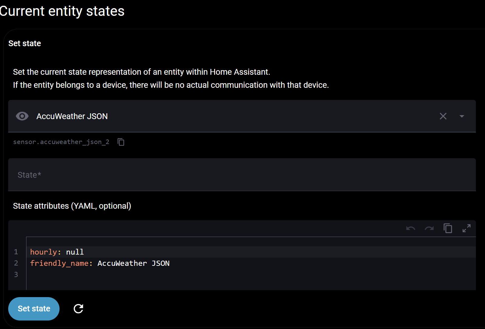

I tried to generate a Weather Dashboard with hourly condition using AccuWeather api. No luck to put a package together using REST platform. I even try to ask ChatGPT for help, no luck. Totally lost. This is what Chat GPT recommend it:
my_accuweather_package:
  sensor:
    - platform: rest
      name: "AccuWeather Raw JSON"
      resource: "https://dataservice.accuweather.com/forecasts/v1/hourly/12hour/329305?apikey=API_KEY&metric=true"
      method: GET
      scan_interval: 1800
    - platform: template
      sensors:
        accuweather_json:
          friendly_name: "AccuWeather JSON"
          value_template: >
            {% set raw = states('sensor.accuweather_raw_json') %}
            {% if raw %}
              {{ (raw | from_json)[0].DateTime }}
            {% else %}
              unavailable
            {% endif %}
          attribute_templates:
            hourly: >
              {% if raw %}
                {{ raw | from_json }}
              {% else %}
              {% endif %}

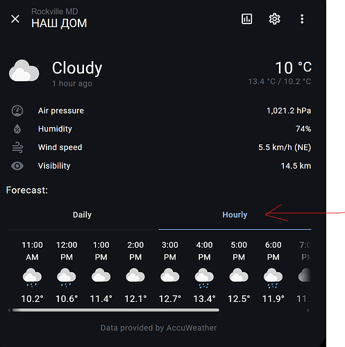

Why not just use the AccuWeather - Home Assistant integration.
Hourly forecasts should be available in HA version 2025.10.0 and later.

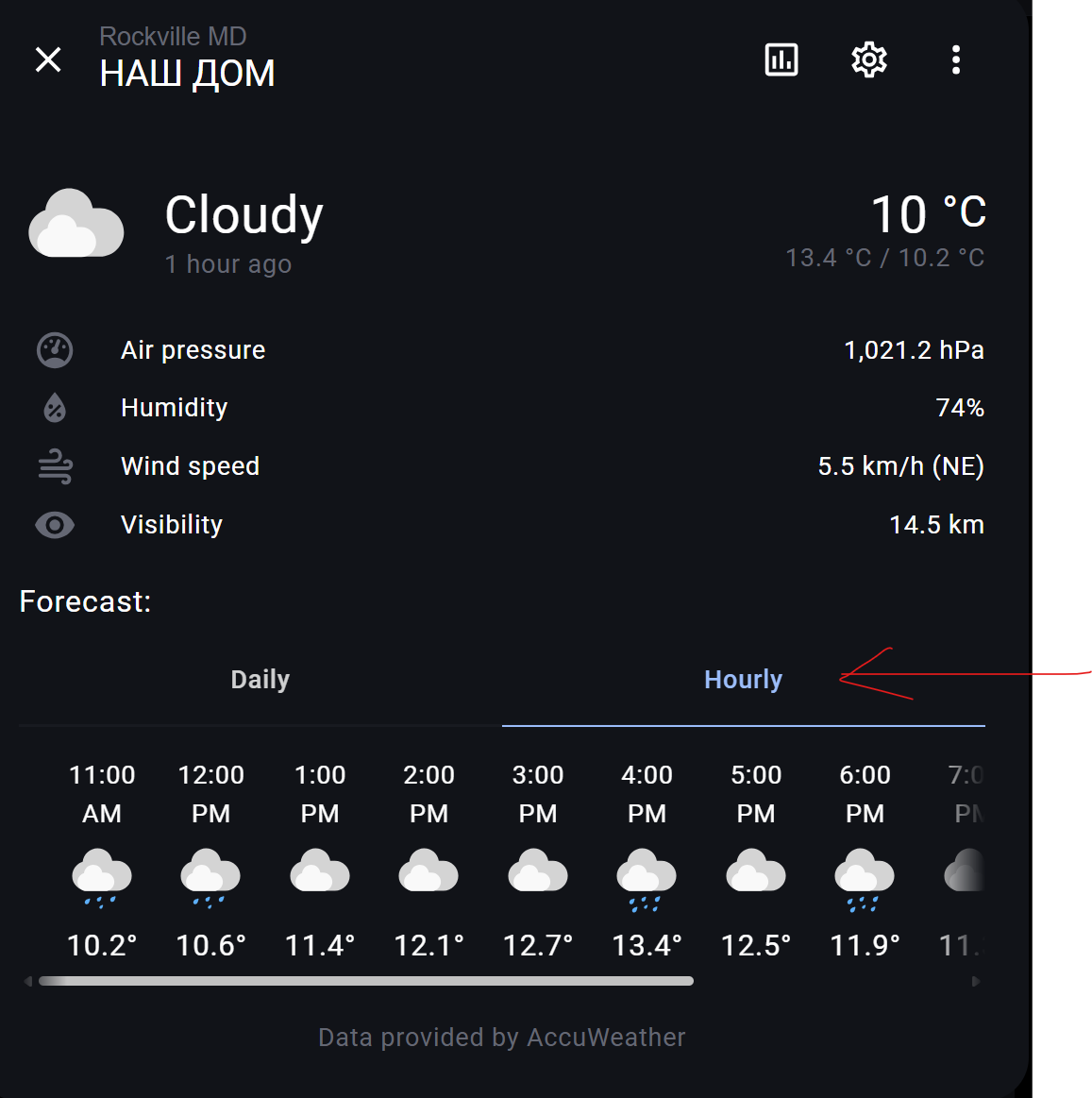

I do,but how I can see hourly forecast in my Dashboard like it’s in integration?
Use the weather.get_forecasts service

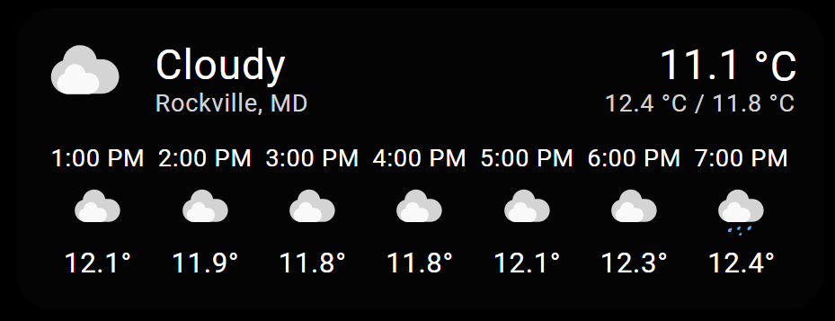

Set the forecast_type to hourly Weather forecast card - Home Assistant
Thank you, that look closer to what I try to accomplish.
I guess the rest of information I can get using separate cards.
TY

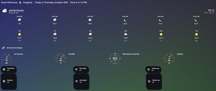

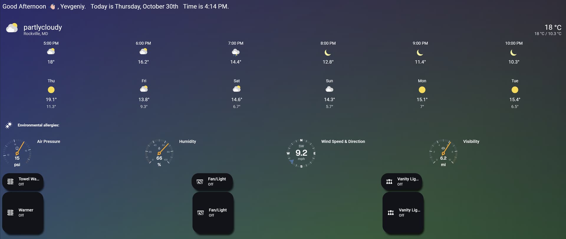

Thank you, guys for your help. This is what I was trying to accomplish for 7-inch tablet in my wife bathroom .
type: vertical-stack
