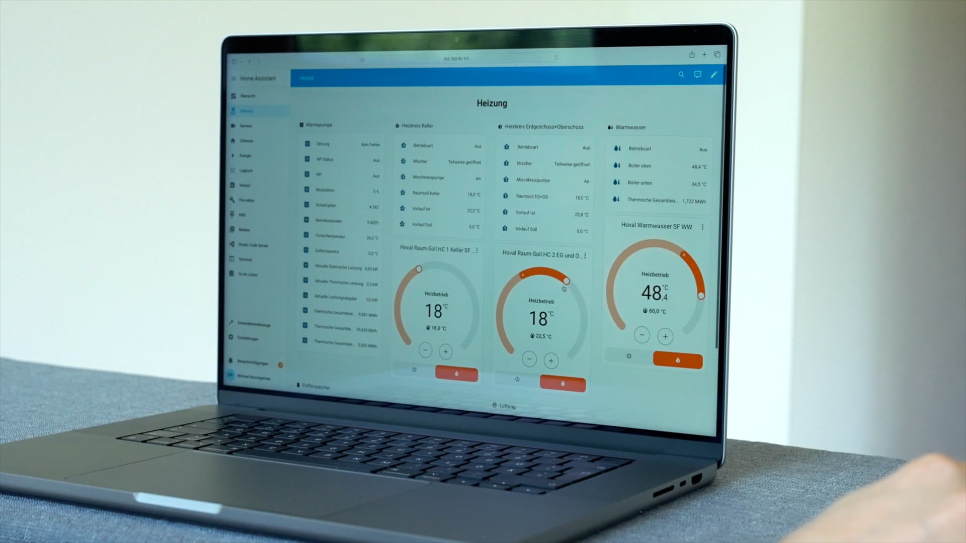

Hello Users,
We accompanied a reference installation this week.
I will now also provide new YAML codes for the hoval plant (heating buffer, domestic hot water, 2 heating circuits, heatpump & ventilation system) in the picture.
We are not currently (this year) planning any hard-coded phyton integration in HACS.
In the meantime, please use the YAML codes.
These are now also for the Hoval HomeVent ventilation systems (ER, FR etc.).
The setpoint adjustment for humidity and ventilation modulation is not yet mapped with the correct unit. (°C).
Greetings

Hello, currently, I have a HovalConnect. I just bought a Modbus. The brand manager tells me that in order for them to intervene remotely, I cannot remove the Connect but that I must add the Modbus in addition (so I cannot sell the Connect). Is this correct? If not, how will they be able to intervene if I only have the Modbus left? Thank you for your feedback.
The Modbus gateway can be installed in addition to the LAN or WLAN gateway OR it can replace it completely!
If you are using a WLAN Gateway and there is no LAN cable, you need to keep the WLAN Gateway.
If the Modbus gateway replaces the LAN or WLAN gateway, Hoval Connect can still be used!
We also clearly recommend using Hoval Connect despite the external connection (in this case Home Assistant) so that Hoval can communicate with you for service purposes (remote access and automatic gateway updates).
also please note: If setpoints are written via Home Assistant:
Hoval Connect and the control by the third-party provider (in this case Home Assistant) do NOT synchronize!
e.g. A room temperature setpoint of 20°C is written cyclically via Home Assistant, in the Hoval Connect app you still see an old set temperature of 22°C.
We are planning a remedy in the next updates to fix this flaw.
Thank you for your clear and detailed explanations.
So I keep the old HovalConnect LAN (as well as the Modbus TCP).
I also confirm that your Yaml code is functional with some adaptations e.g. “°C” replaced by °C
For my part, I only use HovalConnect for the statistics tab. Indeed, for programming, I use the Display (and I hope, in the future, the HomeAssistant Modbus: for example to modify the end date of the holidays)

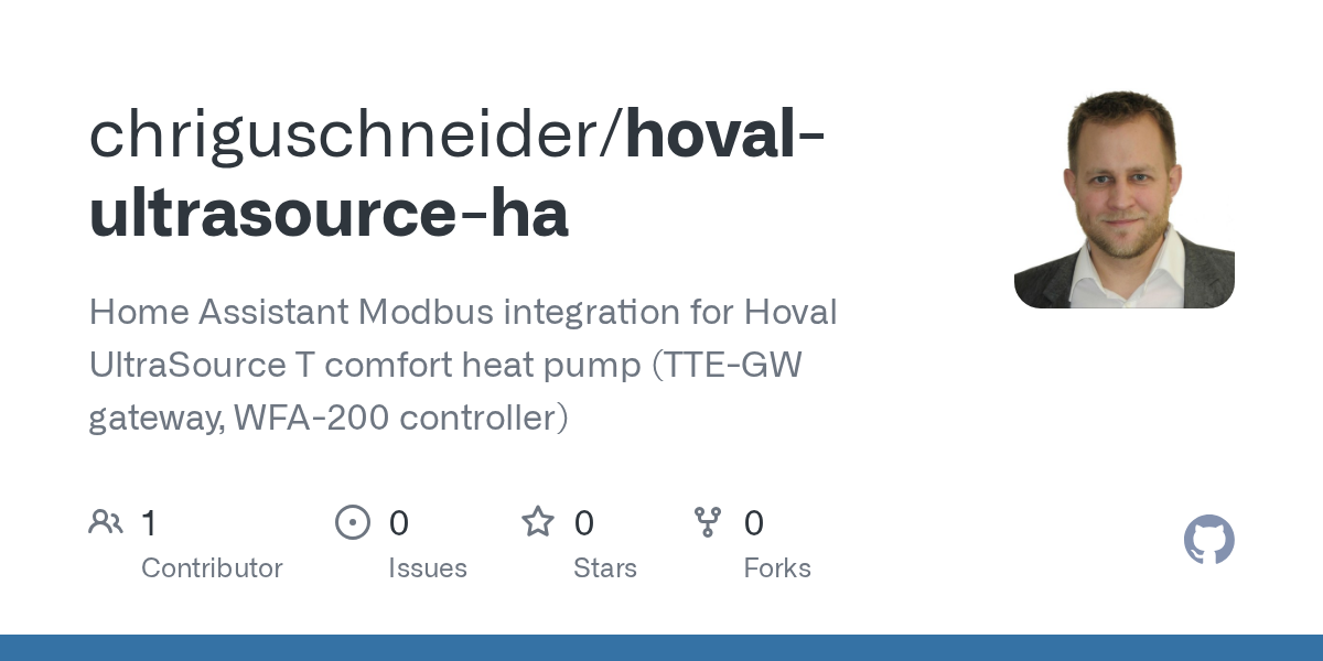

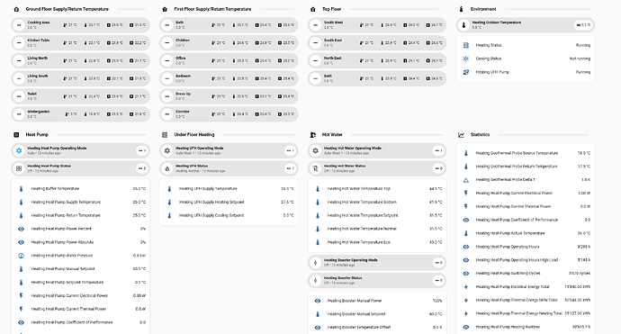

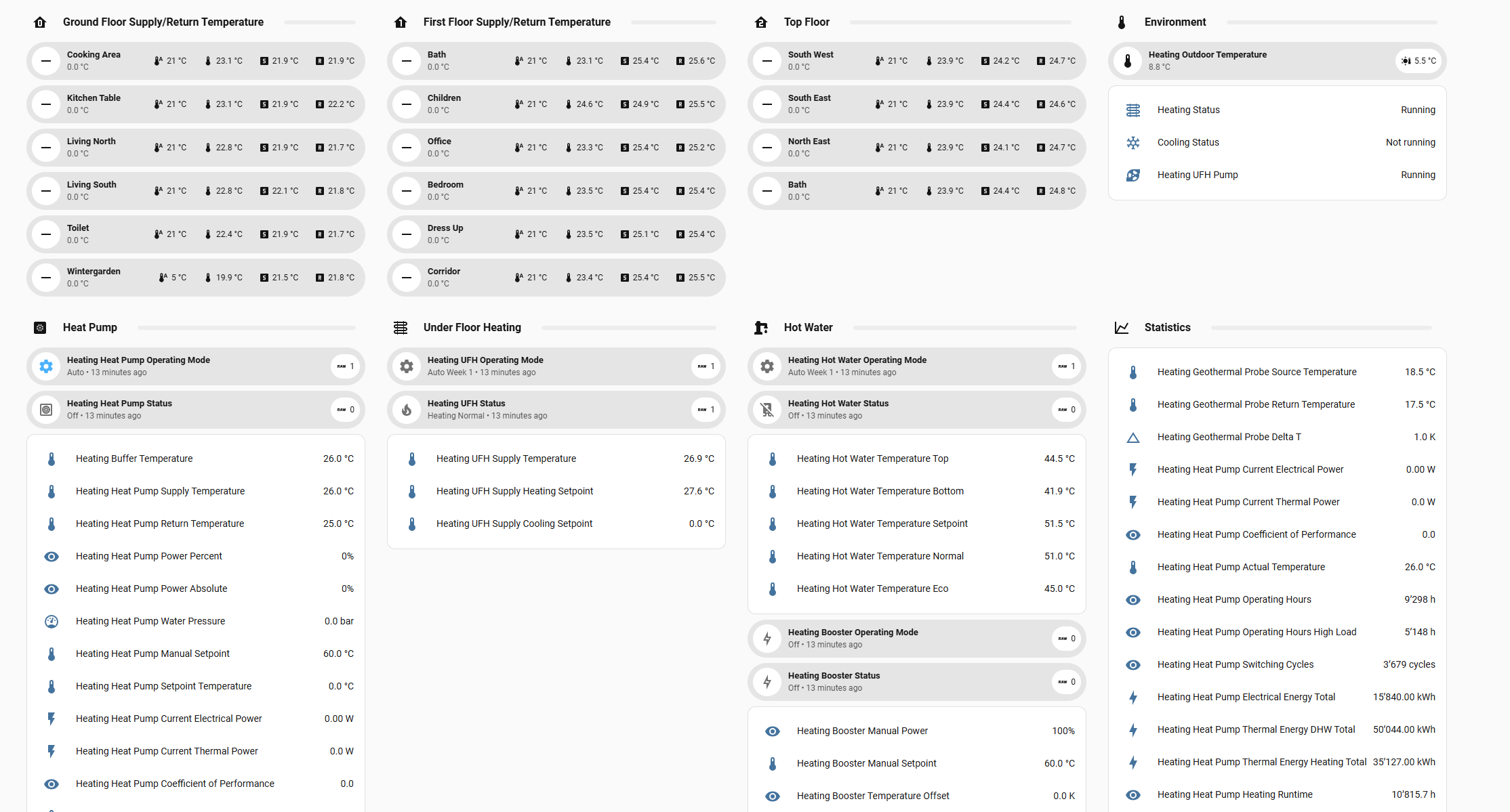

For anyone here on a Hoval UltraSource T comfort with the TTE-GW LAN gateway:
I’ve published my full Home Assistant Modbus integration as a public repo.
It’s a drop-in package — 49 Modbus sensors, 15 templates, mode dropdowns,
setpoint sliders, and write-back automations for DHW / heating / booster.
Plus four Python scanner scripts I used to discover the registers.
Tested against HA Core 2026.4.x and Hoval Modbus datapoints CSV V2-11-009 D.
Hardware reference and adaptation hints for different setups (multi-circuit,
active cooling, etc.) are in docs/hardware.md.

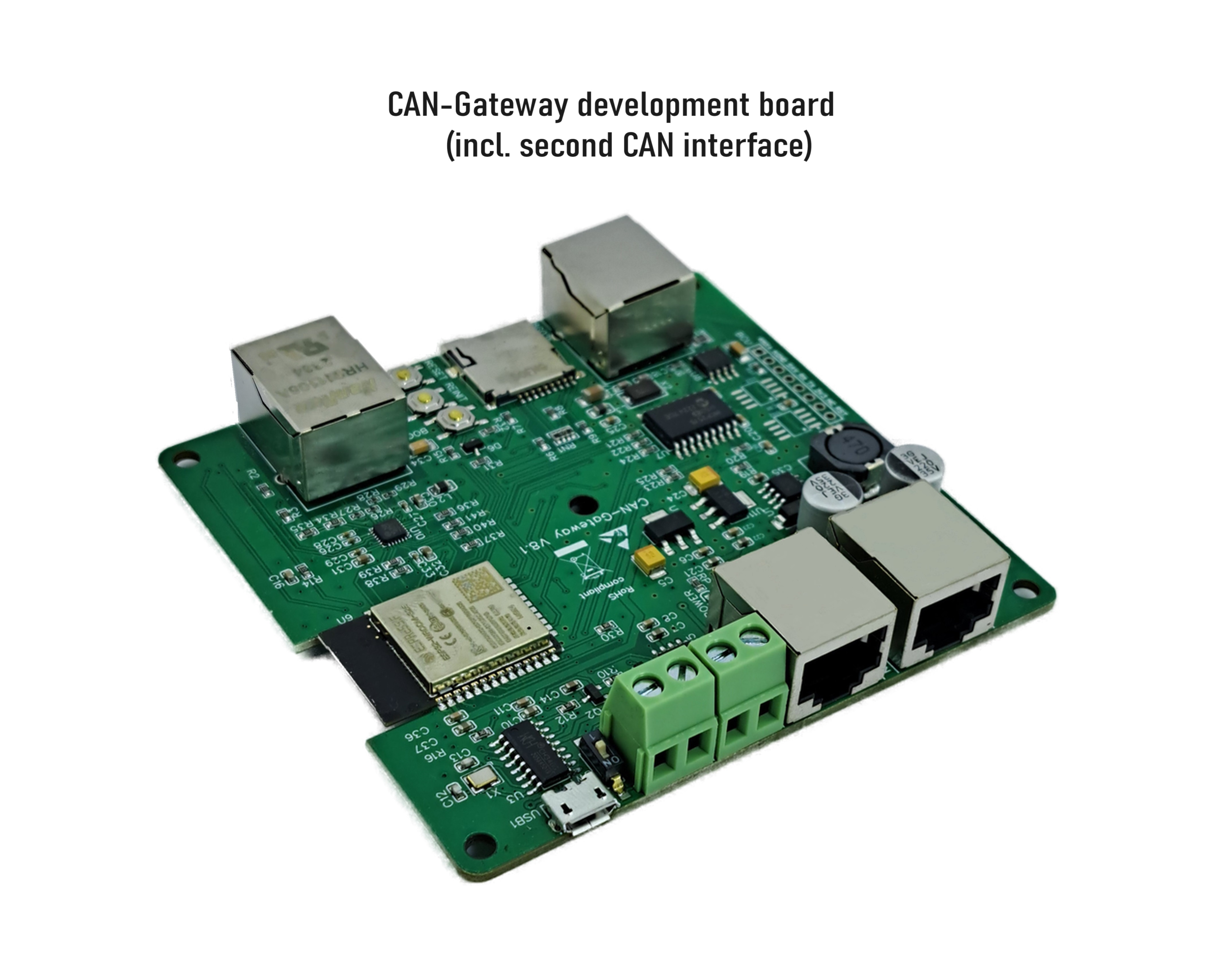

Cool, leider hab ich nur das Connect GW mit der App und hab mir das gebaut: GitHub - chrisunderscorek/hovalconnect-ha: Integrates your hovalconnect mobile app to Home Assistant · GitHub
