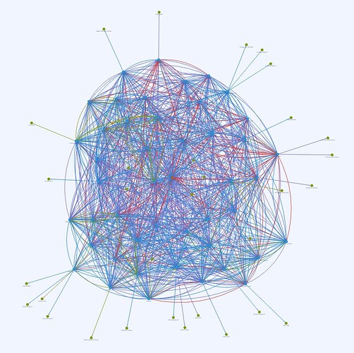

I only have their contact and temperature sensors, but yes these have been working perfectly with a Tubes PoE coordinator and Zigbee2MQTT. I have a pretty well meshed network though:
