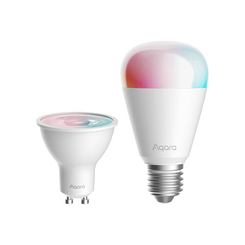

I am just about to return a 4 pack of Aqara bulbs, I was hoping that they would work on my existing Zigbee network (Connect ZBT-2 + Zigbee2MQTT), but they won’t pair.
The Aqara website says “Must use Aqara Zigbee Hub”, if that’s true why advertise them as Zigbee - if you can only use their hub.
Posting here in case I have missed something, if not I am still in the 30 day Amazon return window…

Hi, have you checked the Z2M supported devices list and the notes about pairing?
Thank you for the suggestion.
I believe the bulbs I have are this one: Aqara T2_E26 control via MQTT | Zigbee2MQTT
I don’t see any notes specifically about pairing.
EDIT: I needed to install an app on my phone and use Bluetooth to switch the mode of the bulb (Uses bluetooth to connect and push new firmware).
After doing that I got a bunch of errors in the App saying it needed a Hub, but Zigbee2MQTT did see the bulb and was able to pair it.
So your problem is solved?
Of course they want you to use the app…
Now that you have them in Z2M: can’t you install the new FW from the Z2M webUI?
I am able to use the basic functions of the bulbs: Turn on/off + set color.
Z2M shows effects for the bulbs, but that doesn’t appear to work - I can live with that.
Initializing the bulbs was a catch 22:
  • You can’t push any firmware until the bulb is on Zigbee.
  • You can get the bulb on Zigbee without pushing firmware.
So, I will have to use the app for each new bulb (since you can push the firmware via bluetooth from a phone).

Most recent Aqara devices are dual protocol (Thread & Zigbee, with Thread being the default out of the box).
The instructions manual which comes with the device explains this clearly & tells you only the app is needed to switch protocols.
Did you not RTFM?
You can download the the manual from here:
Please find any mention in the manual that it is possible to use the App without an Aqara Hub to switch protocols …
It is possible (because of Bluetooth) but thats not documented…
BTW The manual online is actually much better than the one in the box that just has pictures - no real text.
