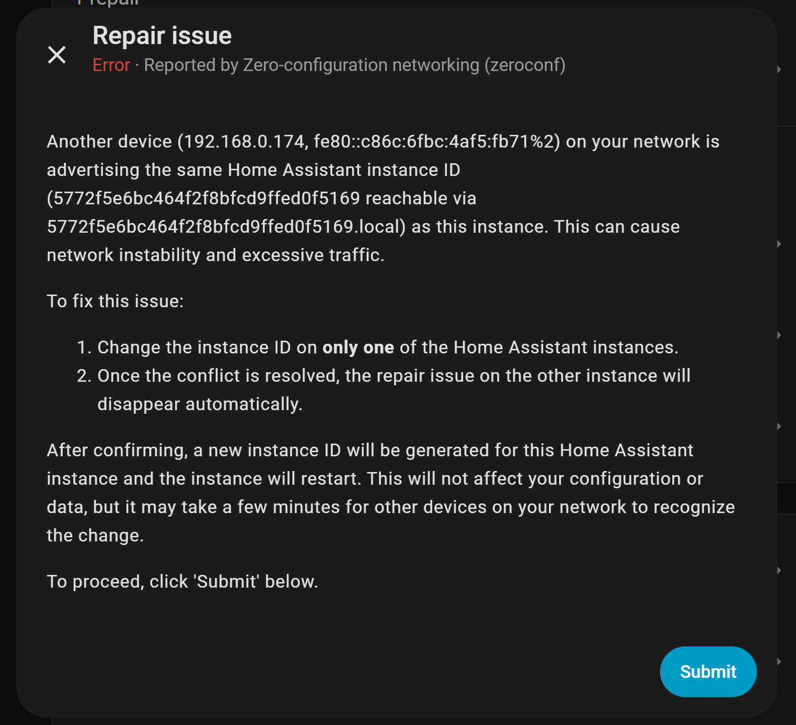

I got this during the last beta since I use my last backup to ‘restore’ a beta instance. There should be an ‘repiar’ issue raised in the front end, if you bring that up there’s a ‘Submit’ button at the bottom that will change that instances id. Mine looked like this…
Thank you! It didn’t appear at first, but after restarting both the new and the old instance it finally came, and it is apparently fixed now. :+1:
