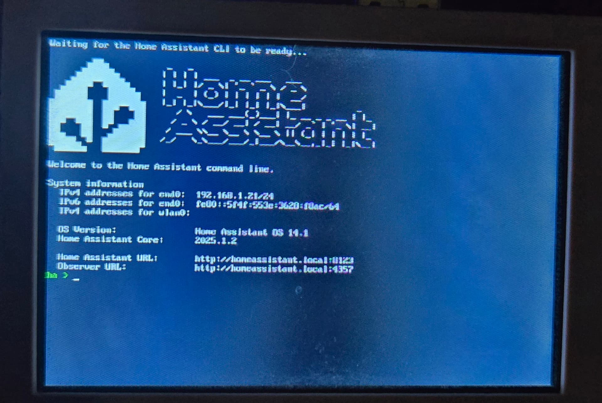

I have RPI5 with small HDMI monitor (resolution is 480x320) and cannot set proper resolution… so text is so small that is unreadable…
It appears that output is always fixed at full HD even if I set lower resolution in config.txt…
Any help would be appreciated

I confirm I get 720x480 resolution working woth cmdline setting… even if it seems to be a “cutted” output from higher 810x540 (or something similar)…
Texts are not perfect but at least readable… better then nothing…

Can you please explain how you increased the size with the cmdline?
video=HDMI-A-1:720x480M@60D in mnt/boot/cmdline.txt
