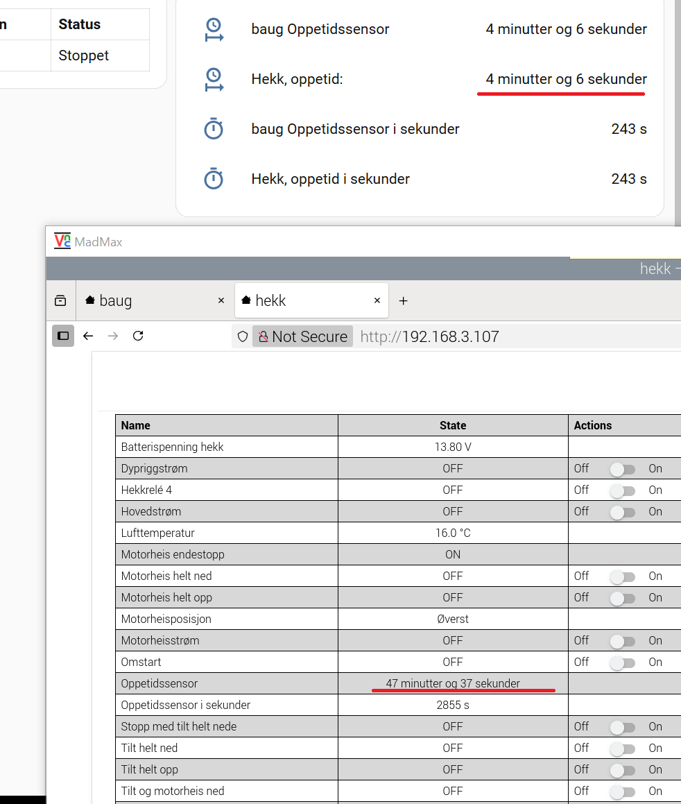

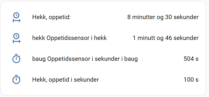

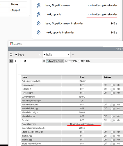

I have so far implemented it in two ESPs and run into a very weird problem. Home Assistant uses the same uptime for both, the latest reboot it seems. Look at the difference between the stern ESP in the ESPHome web server and in Home Assistant (webpage seen through VNC server, it’s one screenshot so taken at exactly the same time):
The sensor “baug Oppetidssensor i sekunder” is the regular uptime sensor, in seconds, so I can have statistics, which of course isn’t possible with the formatted version. That’s identical too in Hass, but totally different in the webpage. Renaming the sensors adding “in bough” and “in stern” at the end fixed it. Still weird that Home Assistant couldn’t separate them, since the MQTT messages in were different:
madmax/baug/sensor/oppetidssensor_i_sekunder/state
madmax/hekk/sensor/oppetidssensor_i_sekunder/state
But it’s working out now. :grin:
