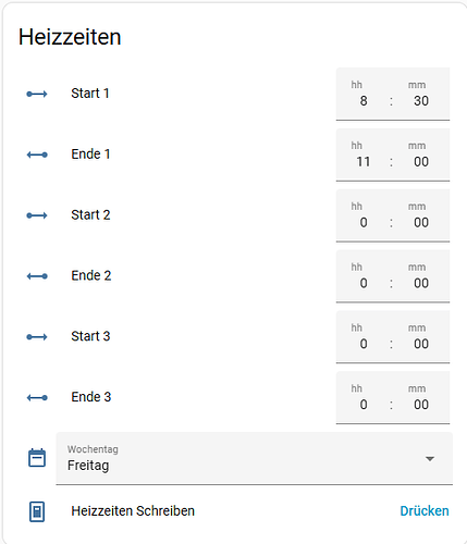

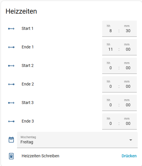

I have written a function that I want to use to program my heating system to heat at certain times and run in frost protection mode at others. I have already configured an interface for this.
When I press “Heizzeiten schreiben” the function should be executed.
How can I call this function when the button is pressed?
