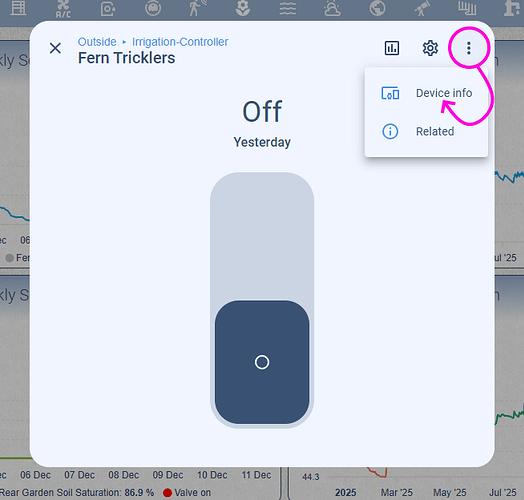

Click on the entity in your dashboard or the entities list. In the pop-up card try this:
There’s nothing there, only ‘related’.

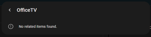

Ok, so it is not part of a device. Click “related”.
Sorry, I should have been more specific. There’s nothing there but an area, no scripts, nothing that I see could create an entity.
Post a screenshot.
On the off chance the area was the issue I removed it. Now it just shows:

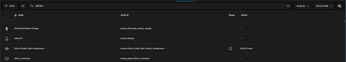

In the entities list does it have this icon next to it?
Nothing next to it:
Further to the right. Under the status column.
I showed the whole line. There’s nothing but a dash under the status and a heavier (bold?) dash under device.
I would have shown the whole screen but searching by is finding anything with even vaguely similar names, not just this one.
Postscript:
I ungrouped, sorted and scrolled and can isolate it with the headers:
