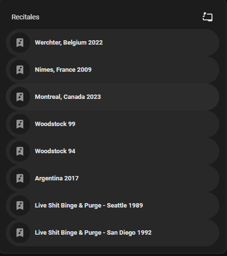

How can I force a vertical scroll?
I have this code
type: custom:expander-card
title: Recitales
icon: mdi:folder-music-outline
cards:
  - type: custom:bubble-card
    card_type: button
    entity: script.metallica_1
    button_type: switch
    name: Werchter, Belgium 2022
    tap_action:
      action: call-service
      service: script.turn_on
        entity_id: script.metallica_1
    card_type: button
    entity: script.metallica_2
    button_type: switch
    name: Nimes, France 2009
    tap_action:
        entity_id: script.metallica_2
    card_type: button
    entity: script.metallica_3
    button_type: switch
    name: Montreal, Canada 2023
    tap_action:
        entity_id: script.metallica_3
    card_type: button
    entity: script.metallica_4
    button_type: switch
    tap_action:
        entity_id: script.metallica_4
    card_type: button
    entity: script.metallica_5
    button_type: switch
    tap_action:
        entity_id: script.metallica_5
    card_type: button
    entity: script.metallica_6
    button_type: switch
    tap_action:
        entity_id: script.metallica_6
    card_type: button
    entity: script.metallica_7
    button_type: switch
    name: Live Shit Binge & Purge - Seattle 1989
    tap_action:
        entity_id: script.metallica_7
    card_type: button
    button_type: switch
    name: Live Shit Binge & Purge - San Diego 1992
    tap_action:
visibility:
  - condition: user
    users:
      - 15393e7a102249fb893bccddb80f826a
and the visual result is shown in the screenshot.
I would like to display 5 buttons, and then for the rest I want them to be visible by scrolling down, because if I add more it will end up being too long.
Thanks in advance
