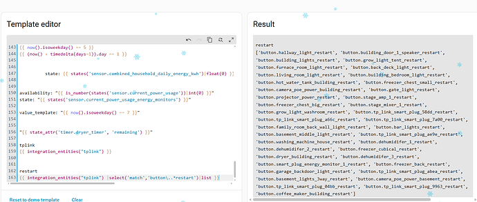

I meant in developer tools → templates
@Hellis81

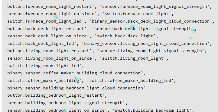

{{ integration_entities("tplink") }}
ok if i did that that the template it generates all the entities i guess
so since i cant copy and paste it un hightlights intstantly
one is
'button.garage_backdoor_light_restart',
so here is a small screen capture
That’s good…

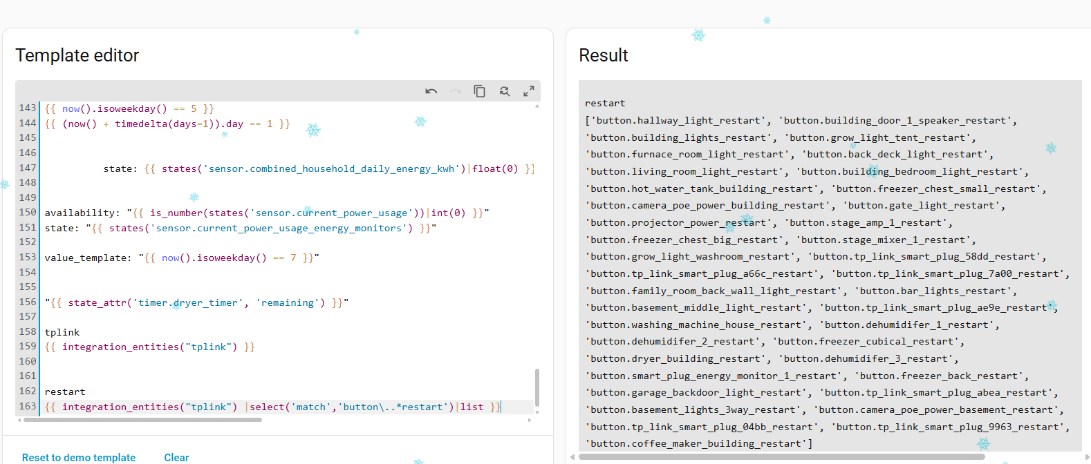

now let’s try this:
{{ integration_entities("tplink") |select('match','button\..*restart')|list }}
Make sure we only get the button entities and only the restart buttons you want.
We don’t want it to press a wrong button
ok so that template is working

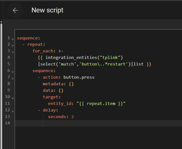

Then create a script with this sequence:
  - repeat:
      for_each: >-

Well that code will never work.
You first need to get the entities then loop and press.
But this is what I meant it should look like:
sequence:
  - repeat:
      for_each: >-
      sequence:
        - action: button.press
          metadata: {}
          data: {}
            entity_id: "{{ repeat.item }}"
        - delay:
            seconds: 2
ok that seems to be working i did get an error but i couldnt copy it or screen capature fast enough saying failed something something devices like where you see “message mailformed”
but it seems to work so it takes 1 entity restarts waits 2 seconds then goes to the 2nd one
is how i take it works
i was able to make it work for my ReoLink Cameras worked easy no more single pressing anymore
