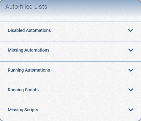

You can enable and disable them in the list at Settings → Automations, however if you install auto-entities and fold-entity-row then you can make lists of entities on your dashboard like this:
type: entities
entities:
  - card:
      head:
        label: Disabled Automations
        type: section
      padding: 0
      type: custom:fold-entity-row
    filter:
      exclude:
        - state: "on"
        - state: unavailable
      include:
        - domain: automation
    sort:
      ignore_case: true
      method: name
    type: custom:auto-entities
  - card:
      head:
        label: Missing Automations
        type: section
      padding: 0
    filter:
      exclude:
        - attributes:
            current: "= 0"
        - attributes:
            current: "= 1"
      include:
    show_empty: true
    sort:
      ignore_case: true
      method: name
  - card:
      head:
        label: Running Automations
        type: section
      padding: 0
    filter:
      exclude:
        - attributes:
            current: "= 0"
      include:
    show_empty: true
    sort:
      ignore_case: true
      method: name
  - card:
      head:
        label: Running Scripts
        type: section
      padding: 0
    filter:
      exclude:
        - state: "off"
      include:
        - domain: script
    show_empty: true
    sort:
      ignore_case: true
      method: name
  - card:
      head:
        label: Missing Scripts
        type: section
      padding: 0
    filter:
      exclude:
        - state: "off"
        - state: "on"
      include:
        - domain: script
    show_empty: true
    sort:
      ignore_case: true
      method: name
show_header_toggle: false
title: Auto-filled Lists
