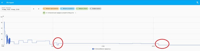

Because first zero is not end of charging algorythm. See real power consumption graph
How many times should the sensor report zero before the switch is turned off?
Your example seems to suggest ten times.
while:
  - condition: template
    value_template: "{{ repeat.index <= 10 }}"
EDIT
The alternative is to detect when the sensor’s value remains zero for at least 10 minutes (or whatever length of time is best).
