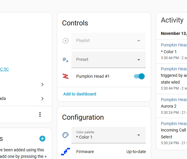

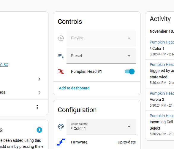

i found glitch if it runs again it will keep the incoming call preset i have… i noticed when it restores… it doesnt Set the “Preset” in the wled the name under devices it leaves it blank… so when it restores i guess its glittchs as it cant restore “unknown” preset
so i tested more it will restore then wont restore… but that seems to be easier then what i trying to do… but ya bit glitchy

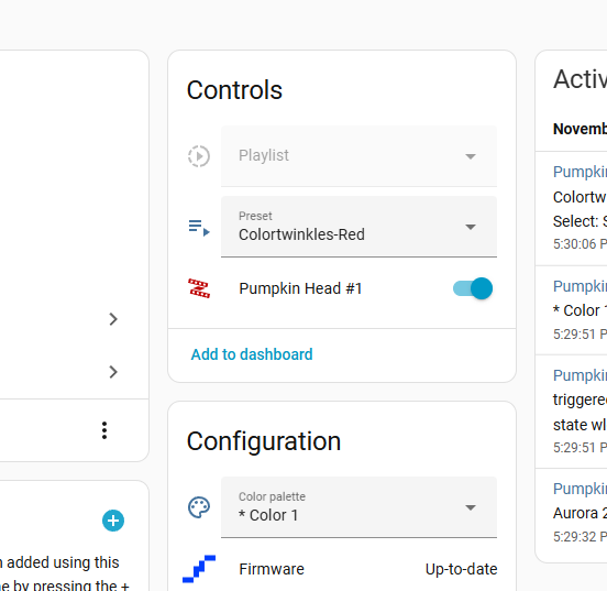

ya what i have is so
is testing my pumpkin head i made
so the current setting is this

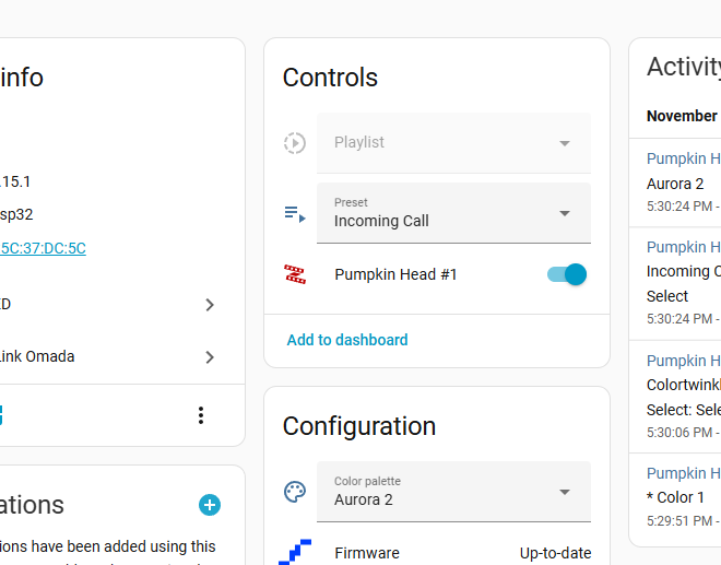

then node red sets the incoming preset
current preset
then my node red runs for 20 seconds and sets the pumpkin to incoming call
and then it runs that restore script above and it glitchs as you see blank preset
