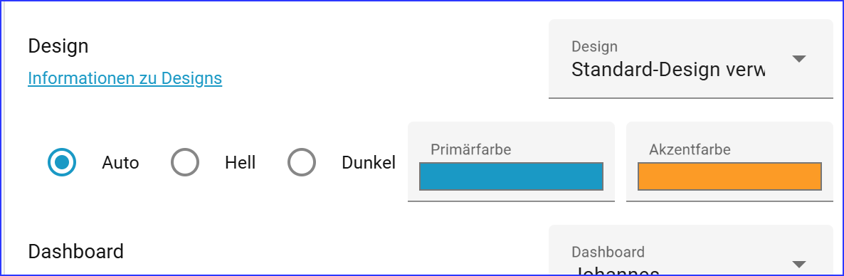

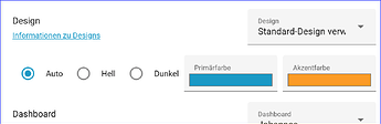

What did you select here for Design?
Auto may use the host system’s properties and switch to light depending on the time.
