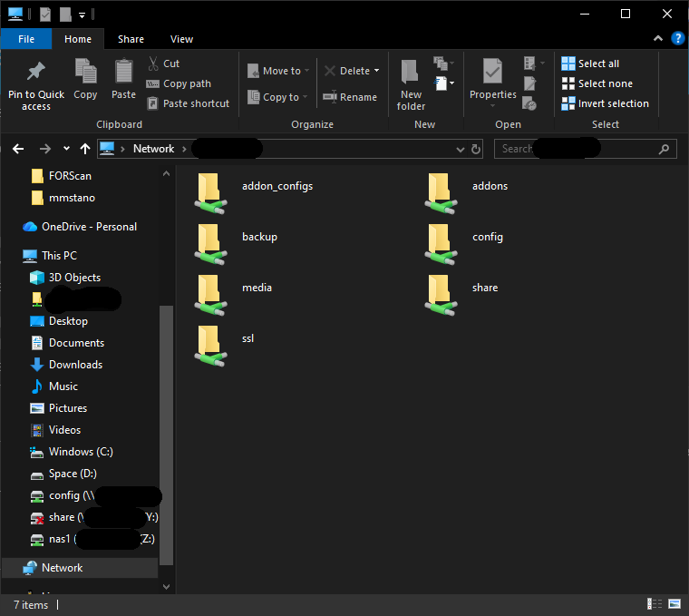

Then this part of those instructions is relevant:
You can in addition find the files via the Samba app within the “ssl” share.
Use the Samba app to pur your files there. Or the SSH Web terminal app.
You are using the wrong tool, File Editor. You are in the Home Assistant core container and cannot access the host filesystem. The File Editor app only exposes /config and /homeassistant folders because they are inside the core container with File Editor.
Install the Advanced SSH & Web Terminal app. Then from a PC on the local network, SSH into the host. Here you can see the host folders like /ssl, /etc, /mnt.
If you setup the SAMBA App, you can access the base folders that rest with the config folder as a network share, including the ssl folder.

I was mistakenly trying to use the File Editor add-on, not realizing that it only has access to the Home Assistant container and not the host filesystem.
Now I understand that I need to use either the Samba add-on to copy the certificate files into the ssl share, or the Advanced SSH & Web Terminal add-on to access the host filesystem directly.

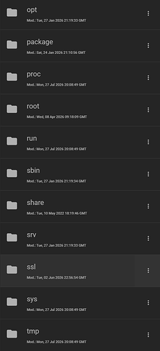

For anyone else reading this in the future, this is only true for the default settings of the File Editor app.
There is an option in the App Config tab called enforce_basepath which is enabled by default. Simply switch it off and you’ll have access to all folders, including SSL:
Disclaimer: Here be Dragons. Switch the setting back off once you’re done. There are files here which can do some massive damage to your system if they are messed with.
:laughing:
Note that besides the actual HA ones, “/homeassistant”, “/ssl”, … the rest of the files belong to the File app container, so not that much risks, actually.
