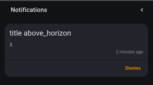

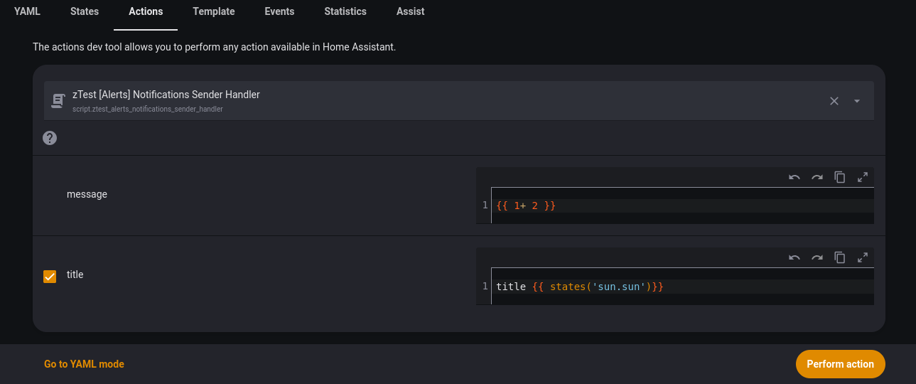

I swapped in a persistent notifcation instead of a mobile notification for testing, but it seems to be working for me when called from the Action tool:
sequence:
  - action: notify.mobile_app_idan_phone
      message: "{{message}}"
      title: "{{title}}"
alias: zTest [Alerts] Notifications Sender Handler
description: ""
fields:
  message:
    selector:
      template: null
    required: true
  title:
    selector:
      template: null
Shocking discovery!
It seems to wiork perfectly fine when runnig the script as action from developer tools,
But it’s not working when you run it with the exact same inputs from the script “more info” dialog, and that’s where i was testing my script.
Seems like a defect.
