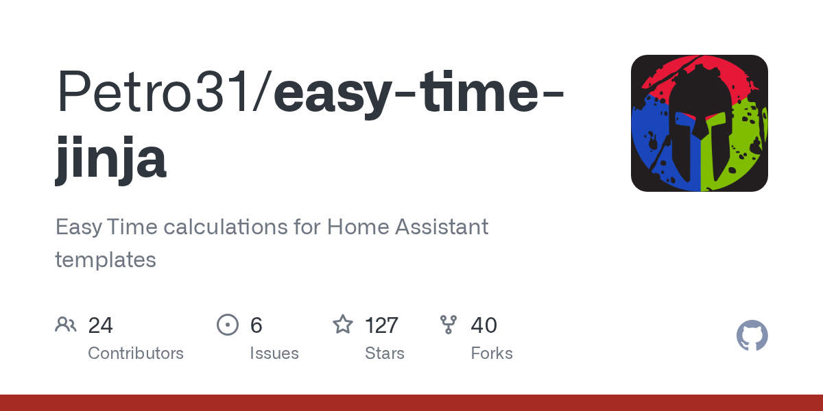

You may even be able to trigger the automation directly from a calendar entry [coming to a future release soon I hear]
When this is 0 and time is 23:00 in April trigger.
And 01:00 if October.
