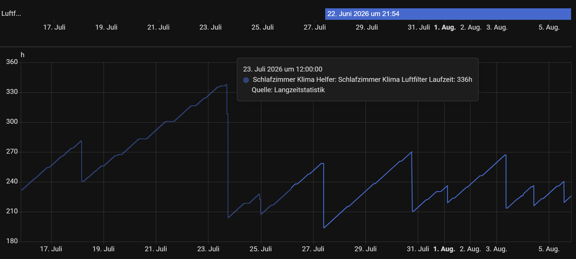

Now, the issue is, that the entity history of the climate (as well as every other entity) is purged after 10 days per default. That leads to the following behavior of the history stats sensor:
The history “forgets” what was the HVAC state was >10 days ago. As a result, the runtime loses track of progress.

Thanks for the hint with MeasureIt.
I used the integration to create new sensors like that:
What:
  • Time
When:
  • Template:
{{ states("climate.bedroom") in ['auto', 'cool', 'fan_only', 'dry', 'heat'] }}
How:
  • Manual/no reset
  • Template:
{{ value / 3600 }}
  • UoM: h
  • Device class: duration
  • State class: total_increasing
For now it looks fine. I’ll keep an eye on this behavior over the long term.
