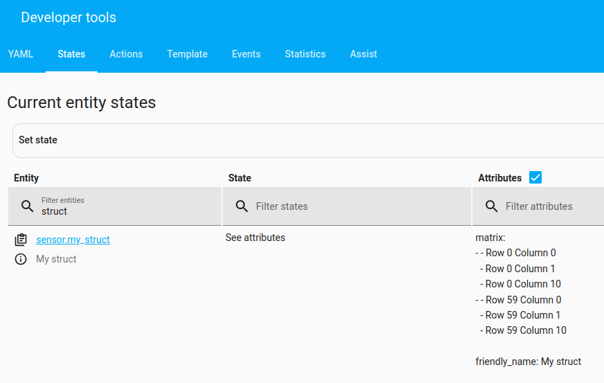

Template sensor? I’ve missed a few rows and columns out but you get the idea:
template:
  - sensor:
    - name: My struct
      state: "See attributes"
      attributes:
        matrix: >
          {{ [ ["Row 0 Column 0",
                "Row 0 Column 1",
                "Row 0 Column 10"],
               ["Row 59 Column 0",
                "Row 59 Column 1",
                "Row 59 Column 10"]

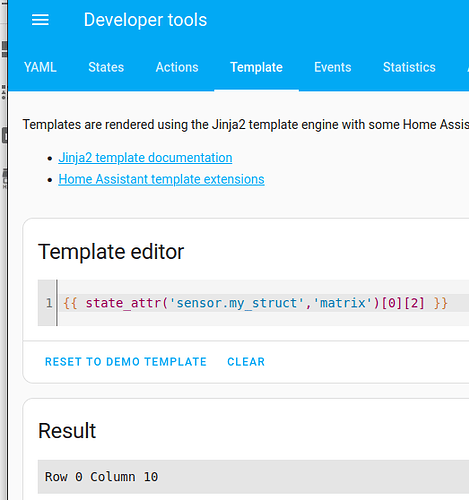

Access with e.g. state_attr('sensor.my_struct','matrix')[0][2]:
