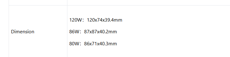

Not too hard to find, really…
Hello
Thanks for the Reply.
I did find those Dimensions, however, is that the Total Depth or…
Kevin
IDK where you live, but over here (Belgium), boxes are typically 40 or 50mm.
I’d go for 50.
