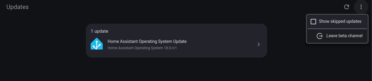

Usually it means, at some point, you clicked the option to join the Beta Channel in the expansion menu of the Updates Settings. If you don't want to be offered beta releases and RC's, you can click "Leave beta channel".

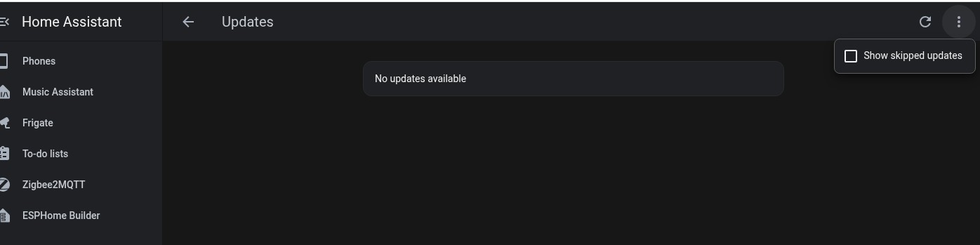

I figured that might be the case, but I don't remember doing it, and I don't see that entry. take a look.

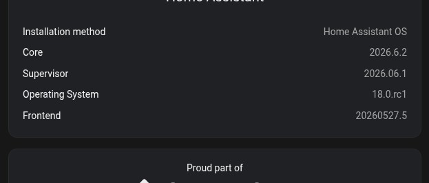

Wait, just checked again and it showed up. And as I expected, I have never joined the beta channel. Not ever. Could this be an issue for a lot of people with this RC?
And I'm definitely on rc1.
