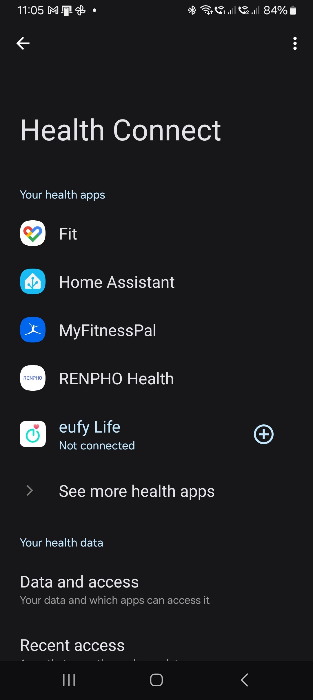

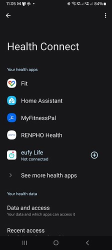

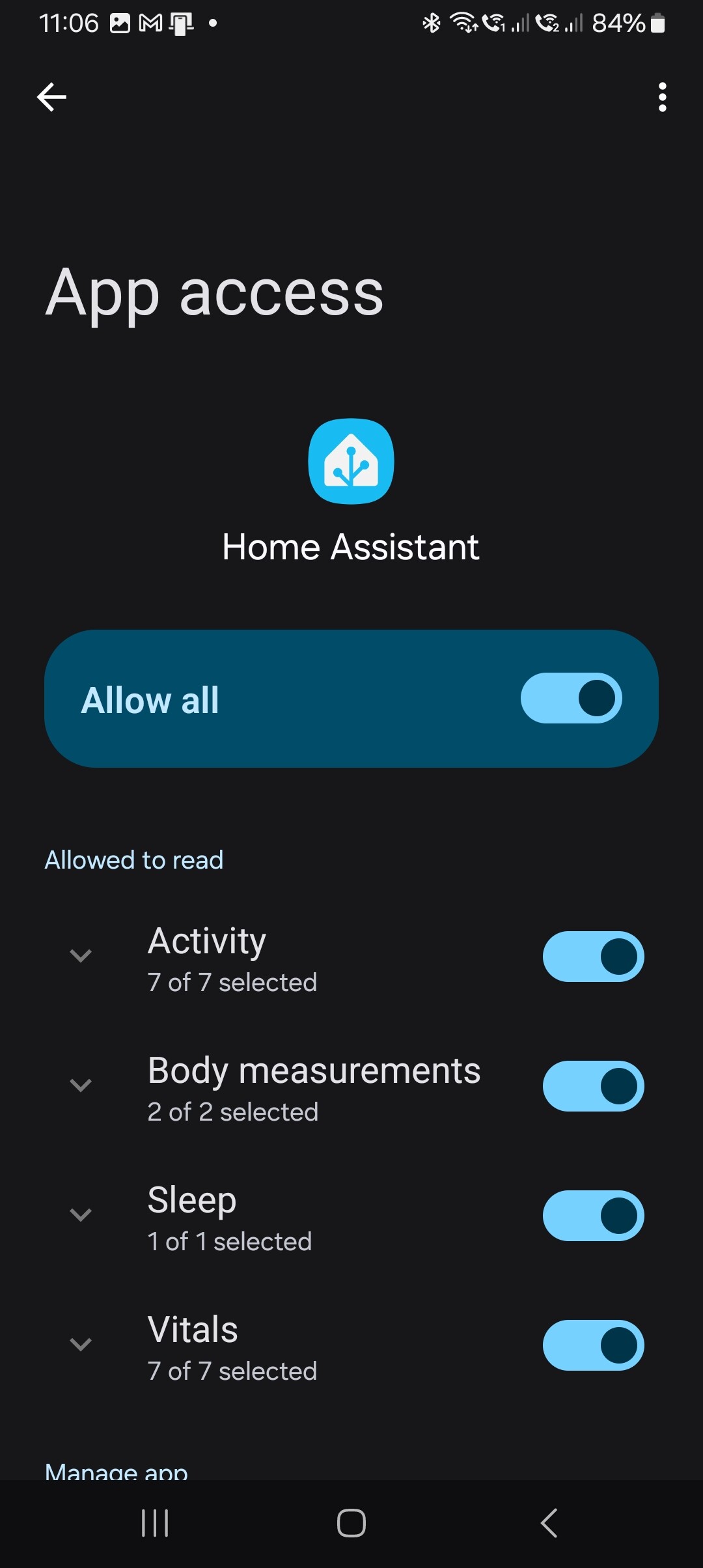

My Samsung Galaxy phone has Health Connect in Settings (it told me to uninstall the app to save space) and is aware of Home Assistant, so gave it access to all the data items (see screenshots), but I can’t see anything new in HA and there doesn’t seem to be either Google or Samsung integration for Health Connect. How do I access the data?
You seem to have enabled Android -> HA App, but not HA App -> HA to get the data into HA.
  • Android App → Settings → Companion App → Sensors → Manage Sensors → Health Connect sensors
Then weight 15 mins (the default reporting period) and search under Settings → Developer Tools → Statistics for matching entities that HA is collecting.
