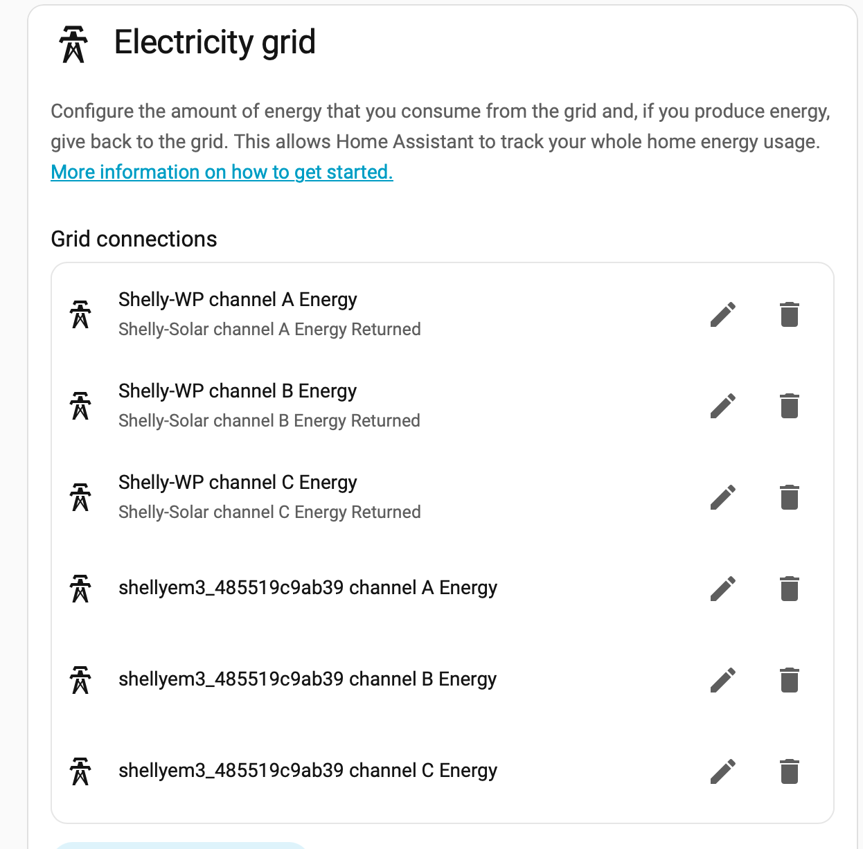

Three years ago I installed 3 shelly3em devices to monitor the grid consumption for “normal” and heat pump usage, and the energy returned from my PV panels, 100% feed to the grid.
After the latest update of HA my config looks like this:
Now my electrician installed a battery and rewired a lot so that I consume my own PV energy. I will add another shelly to measure the battery energy flows (as - as of now - there is no working integration for the battery).
Now I want to change my energy settings, but not loose historic data. The heat pump stays like it is, but of course I need to change the settings for PV and normal usage to reflect reality, and add the new shelly for battery. How do I do this? I thought about resetting the PV and normal usage device to factory, rename the existing entities to “legacy”. But I have read that once I reuse the old shellys for solar etc HA will “repair” everything so it gets messed up?

But I think I managed: fiddling with the database (in table statistics_meta renaming the respective sensors to some non existing names and editing the config file for energy /.storage/energy to use these new names) I have the history fixed forever, I hope.
Alas, having set up the new entities the power flow chart looks strange, but I will open a new topic for this.

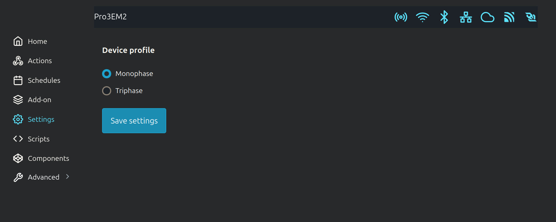

Shelly’s documentation is lacking here. Goto the web interface of the device → Settings → Device Profile. This setting toggles between showing 1 energy device (sum) or 3 separate ones.

Ok, Now I understand, because today my new 3em PRO arrived…indeed it has this setting. But the old ones are 3em (w/o pro), they do not have this setting.
