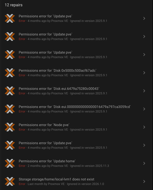

I got this repair errors which is very annoying and yes its already fixed and workin fine. Accept for the repair error which cant be done.
Anyone have any ideas on how to remove it?
Try restarting HA. If that doesn’t clear the repairs, then you’re gonna have to click them one by one and click Ignore (or whatever the option is called)
done so many times… its never clear and yes its on ignore list… but its annoying wakakakaka
Just a thought, it’s all “by Proxmox” , could this be a “hint” ?
Another though, if i recall right … click Un-Ignore and it could end up vanishing , maybe first after a restart, maybe directly “puff” ![]()
yup… try it before… it never get remove
Ok, i don’t have long experience with Proxmox, had it on baremetal ones, just found it as yet another Maintenance-Troubleshooting task, so i dropped it, sufficient/“adequate” hardware is not a factor
IF you are up-to-it
.storage/repairs.issue_registry
Make a backup first ![]()
got it fixed… thank you soo much…
