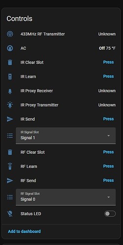

So after I saw the post about how Iotorero joined the Works for Home Assistant program I decided to browse there catalogue again and found the RF IR remote which is pre flashed with ESPHome. I bought it thinking I could just use the learn remote command in the Action section of Developer tools.
Well it doesn’t work that way. After asking AI, I updated it in ESPHome and received a bunch of new entities. After that I thought it was as simple as choosing a slot, learning a press with that slot and then sending the command. When I did that, it would say the command was learned. And when I hit send, it would say it was sent. But my ceiling fan does nothing.
